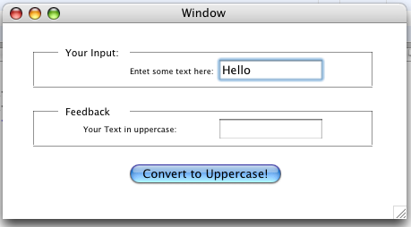

Hello, I have the following problem. I have made this window:
attachment.php
which is self-explanatory. All command event handlers are handled properly.
There is one problem though. Below is the code that handles the conversion to uppercase:

the problem is that I don't see any letters drawn on the second text field! What is my fault?
