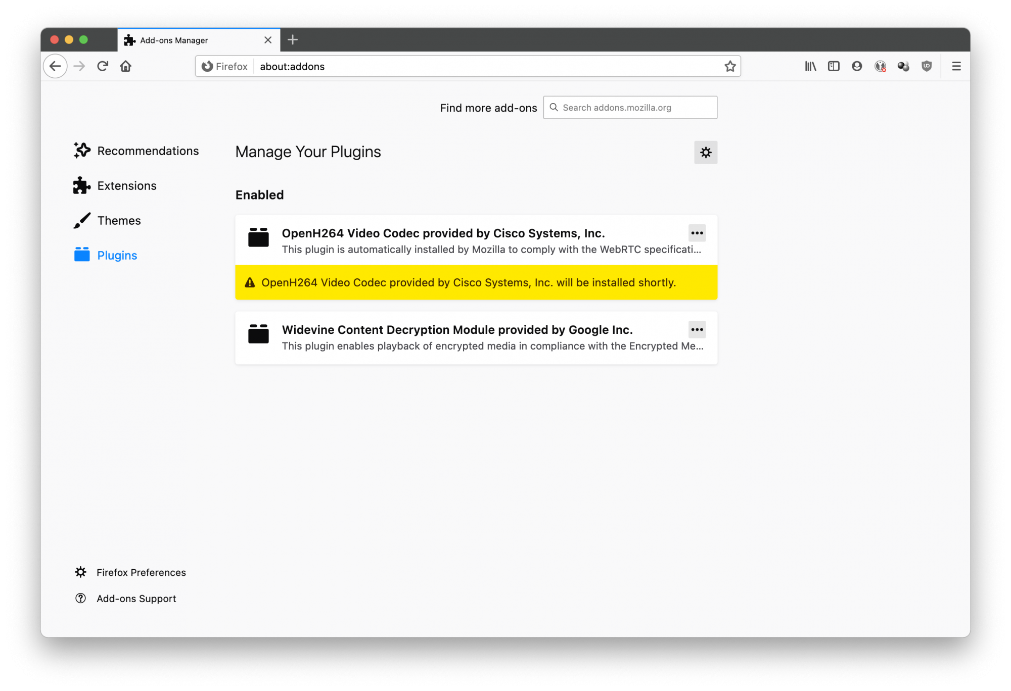

It says it will be installed shortly, under "Enabled" category. Screen Shot 2021-03-30 at 13.22.24.png
Reactions: leons
Thanks VERY much. 🙂 That's what I am looking for to report to Mozilla. It is possible that most/all MI/Firefox users have this issue. (If it says that, it will NEVER install). Others, please check and report if you have Firefox installed on your M1. It takes literally 10 seconds to check.

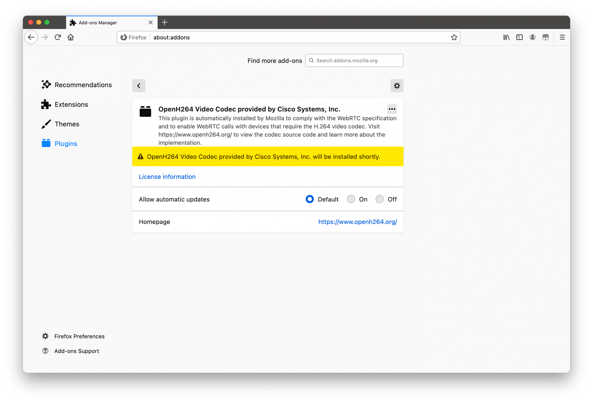

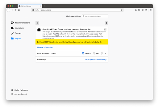

It is November now and I am also seeing this issue on my new macbook pro (M1). Has anyone found a solution to this? Is there no codec available for AS?
I seem to have the update on M1 Air and FF 94.0.1.
I never did any manual change of this.
OpenH264 Video Codec provided by Cisco Systems, Inc.​
This plugin is automatically installed by Mozilla to comply with the WebRTC specification and to enable WebRTC calls with devices that require the H.264 video codec. Visit https://www.openh264.org/ to view the codec source code and learn more about the implementation.
Allow automatic updates Default
Version 1.8.1.1
Last Updated April 3, 2021
