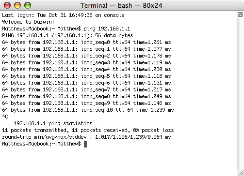

Try getting her to connect wirelessly to the Airport Extreme and load up Terminal (in Applications/Utilities) and then type
'ping 10.0.1.1' without quotations and press enter.
You should get something like the following expect that I use a netgear router which has a different IP address to the Airport...
If it doesn't display anything about every second it isn't really connecting to the router.
After a while press Ctrl and C at the same time (same as Copy on Windows), if it says 100% packet loss (or over 10% packet loss) then the computer isn't connecting to the Airport properly.
Report back the results of this.
