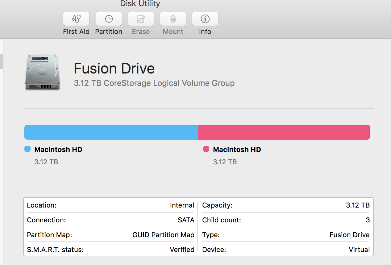

Hello,
Just recently purchased the new iMac and tried to install Windows. There was a problem on the Windows side and the installation crashed leaving a partition that could no longer be removed. Used apple support to try and remove it and they said the best thing to do was to recreate the fusion drive. A strange thing seems to have happened though where I now have two Macintosh HD. Is there anyway to remove the other one as this doesn't look like a thing that should be happening.
Thanks!

It could just be that Spotlight is indexing the volume incorrectly. Might be worth trying the following as first step?
https://support.apple.com/en-us/HT201716

I'll wait a few hours until spotlight has done it's thing and then have a look again. I was trying to install Windows 10, whoever was to blame it has not been good for me. Currently setting up parallels until I can sort out the problem.

I think this may be why I'm seeing two Macintosh HD's
Code:
/dev/disk2 (internal, virtual):
   #:                       TYPE NAME                    SIZE       IDENTIFIER
   0:                  Apple_HFS Macintosh HD           +3.1 TB     disk2
                                 Logical Volume on disk1s2, disk0s2, ...
Whenever I try to use bootcamp it now just gives me an error of "The startup fisk cannot be partitioned or restored to a single partition"

I managed to get it working on an external hard drive which is good enough for what I need it for. Not using it for gaming or anything like that. I will have to fix it in the future but for the time being it works and I can do work :)
