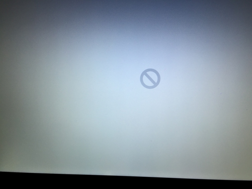

Here's a pic
So I tried a few more things I used the same enclosure and new hdd and I tried to boot from my own Mac didn't work, I used my own bootable back up disk on both macs and even that proved problematic, only time I managed is if I connected the enclosure to my TB display this could be due to a finicky enclosure hard to say right now
This is kinda confusing. Do you have another enclosure you can try?
Nope, but I figure if I want it to work I have to get it fixed anyways right so nothing much I can do I guess I'll get someone to look at it and see what happens will update when I know
