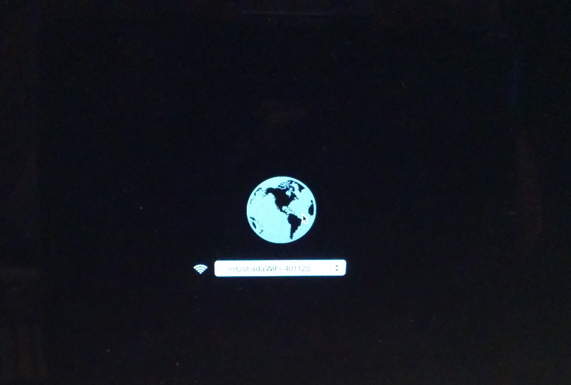

Hi everyone,
I have the following problem: I have initialized my Mac and after, I have turned off it instead of proceeding to the new reinstallation because I have wanted to proceed via internet recovery installation. Now, I have tried more and more times to reinstall the OSX but the Mac is blocked at the following screen (I chose the WiFi), and after about 15 minutes shows the following error code (2002F).
Also, I tried with command + r but I can't access at disk utility but I can only access at internet recovery.
Now, there is not partition disk.
Please, help me to resolve this problem.
Thanks in advance.

Hi everyone,
Thanks in advance.

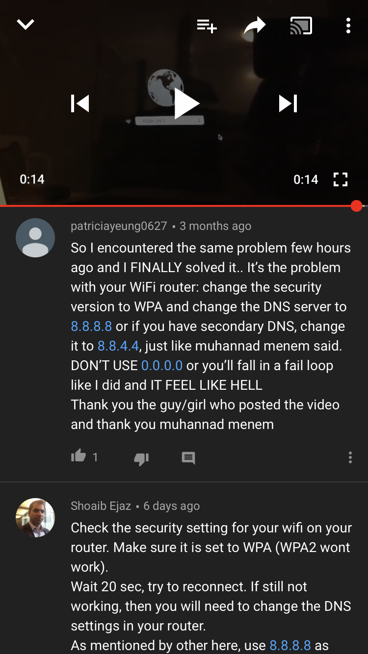

Its the problem with router not your mac use eternet cable or change the security version to WPA and change DNS server to 8.8.8.8 and secondary dns(If you have one) to 8.8.4.4
