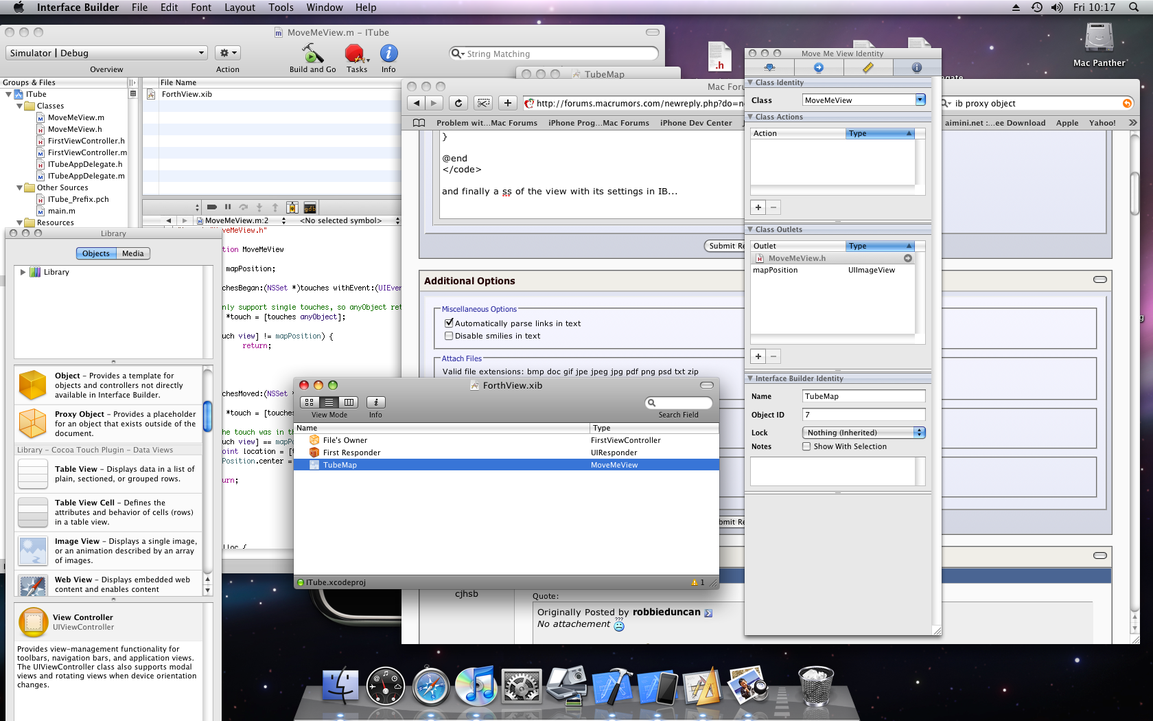

I wanted to compare it with the instance of TubeMap (so if the screen is touched within this view then the method does something). If I change tubeMap to if ([touch view] != (UIView *tubeMap)) I get a syntax error before 'tubeMap', which obviously means I'm still not understanding something fundamental.
This tells you that neither tubeMap (class TubeMap) or it's superclasses have a center property. Did you mean to use self instead? MoveMeView is a UIView so instances of that have a center property...
Ah thanks - at least I was right about what the error was trying to say, even if I don't get why. Am I right in assuming that the class and superclasses don't have a center property because it's the instance of the view that does? I'm trying to get the instance of TubeMap that is on the screen to re-center under the user's touch, displaying the part of the graphic in the view that is currently clipped offscreen.
Just FYI when I do reference it to self it compiles, but then doesn't display in the simulator anyway....and I thought this would be an easy way to learn...😀
Add this to the top of MoveMeView.m
#import "TubeMap.h"
gcc's error messages suck dead donkey (well you know). This error means that gcc doesn't know what TubeMap is.
Sadly there is no TubeMap.h - TubeMap is a view that is made by ForthView.xib, which is one of 4 nibs that I've built to house 4 tab options of the app. It loads fine without including moveme.m and .h in the project, but when I change the final error in moveme.m from tubeMap.center to self.center the view is white-screen (no crash) for that tab - I think at this point IB is actually causing me a lot of pain as if I'd just written it programatically it would of been a huge amount clearer.
ForthView.xib

Any further thoughts guys?
Your UIView cast is wrong. It should be:
Code:
((UIView *) tubeMap)
not
Code:
(UIView* tubeMap)
What is TubeMap? A custom UIView subclass? If so there has to be code for this to exist. Simply changing the class to this in IB will not work: you need to have IB create the skeleton files and implement the class.
Code:
not
Code:
(UIView* tubeMap)
Ah thanks - I knew I was missing something fundamental about how to cast!

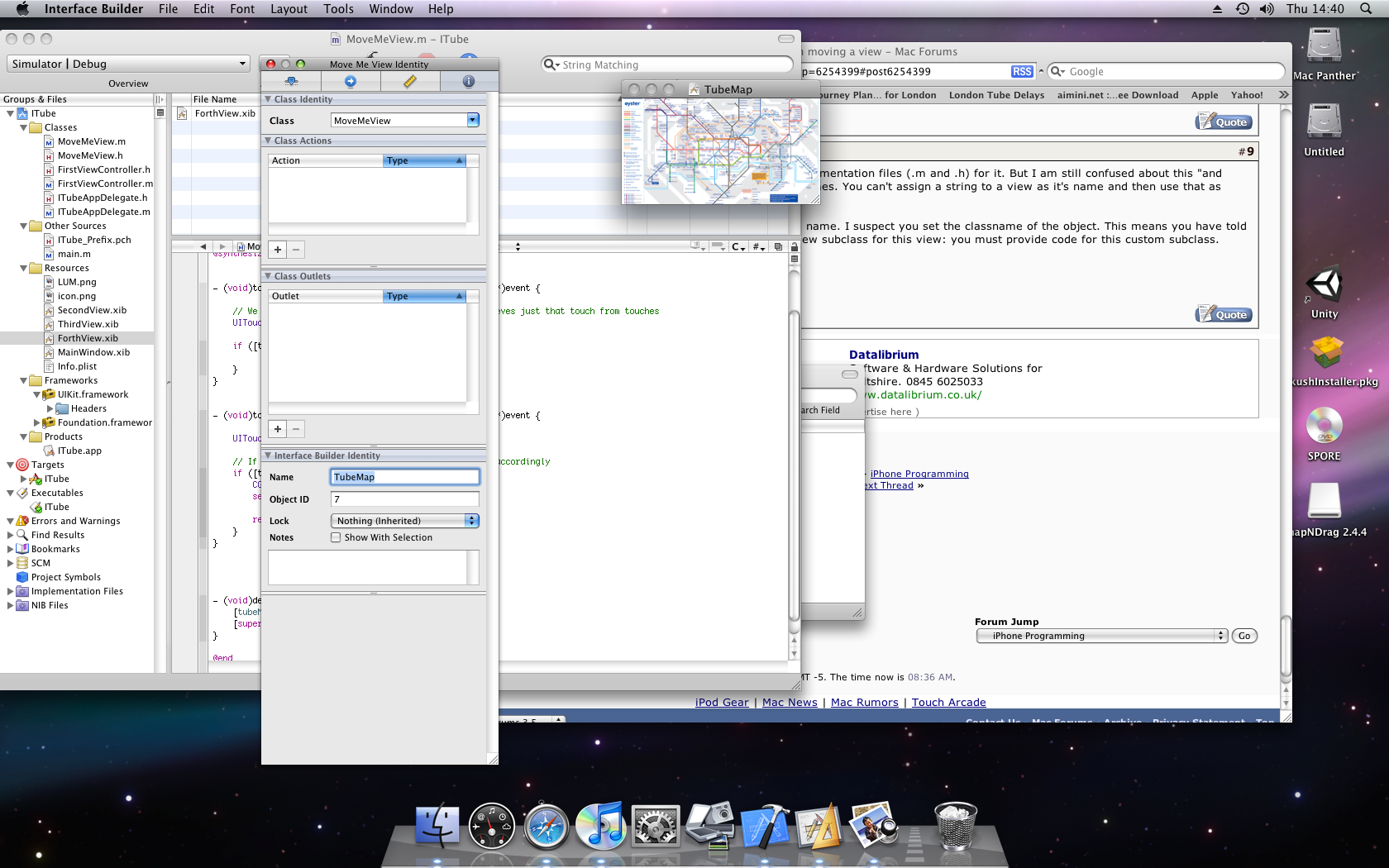

That still returns an error, but I think were actually getting to the problem now, and it looks like my lack of understanding about IB.
TubeMap is the name which I gave the view object in ForthView.xib and then changed it's class type from UIImageView to MoveMeView. Since it compiles ok and runs fine when I remove movemeview.h and .m and revert the class to UIImageView, I had assumed that the IB file created an object instance with that name, which must have a class, so I have been trying to get movemeview to control the instance of TubeMap. I hope that makes sense somehow...?
Style note: don't start instance variable names with a capital: everyone else will read that as a class name.
What do you mean by "TubeMap is the name which I gave the view object". Objects don't have names.
I thought it was a class name.
Ok, I'm not using the right terminology here I think and causing more confusion; my apologies.

Post a screenshot of where you set the name. I suspect you set the classname of the object. This means you have told IB that you will be using a custom UIView subclass for this view: you must provide code for this custom subclass.
If TubeMap is a class then you need implementation files (.m and .h) for it. But I am still confused about this "and named it TubeMap". Views don't have names. You can't assign a string to a view as it's name and then use that as some sort of global identifier for the view.
Ah ok then this is where my assumption is falling down; I assumed you could!
Attached SS is where I am setting the name; how would I reference it then if not by name?
No attachement 😕
Edit: and now there is 🙂
Edit again: that name is only usable from Interface Builder (I think). It certainly doesn't translate to a global variable in XCode. It may be possible to programatically step through the view tree querying names, or even ask a UIWindow for an object by name like you can by tag.
The normal way to get a reference to a view would be to have an IBOutlet in the file owner (custom class) that will get linked to the object it's connected to when the nib/xib is loaded.

Yet another edit: UIView is just like it's NS counterparty: you can search for subviews by tag but there is no corresponding by name search. That name is only really to help searches in IB I think.

and finally a ss of the view with its settings in IB...
Many thanks!
MoveMeView must either have a draw method or a subview. Is the view that contains the map added as a subview?
Also please use code tags!
Sorry about the code wrappers - I was fixing them as you were posting - your just too fast responding for me to even fix my post errors! 😀

I was assuming you'd add the subview in IB. If you are trying to add it in code you need a pointer to that object as per usual. How you get that pointer depends largely on where the object is created. If you are creating it in code you have the pointer: it's up to you how you pass this reference around to get it where you need it. If you create the view in IB but don't add it as a subview then an IBOutlet would be the easiest way.
Personally in my iPhone projects so far I've given up on using IB at all: I just create the entire interface programatically.
Ah ok yes I did add it in IB; I think I'm starting to understand now. Equally, I think my hatred of IB is growing at the same rate. Many thanks again for helping me along my first steps!
