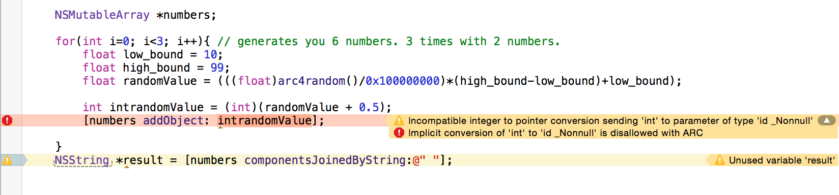

I've changed a bit the code to improve it and I've got the following error in the code (screenshot) enclosed.

Ok, it looks like you are trying to store an int into an NSMutableArray.
One approach would be to change the storage to one that takes ints. However, you could also just grab the 4 random numbers and add them to a string inside the for loop. This would bypass the array and save time/memory probably because you don't really need the array.
Probably have to create an empty string outside the loop, add the random converted to a string to that string, then return the string outside the loop.

You can't save int type directly into an NSMutableDictionary, you need to wrap it in a type it can hold, NSNumber.
Code:
NSNumber *number = [[NSNumber alloc] initWithInt:<your int>];
[numbers addObject:number];
