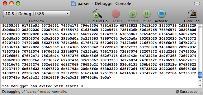

when i tried to print out the contents of the htmldata(NSData) this was the output :
attachment.php
this is a simple parser program that use JUJU HTML Parser which inspired by Hpple Parser.
aside from that print my program does not have any error . but also does not have any result !

Use simpler and smaller data.
Use a simpler and smaller xpath expression.
Post the HTML text you're parsing, so we know what to expect. It could be the program is working perfectly, but your data doesn't contain the xpath expression you're expecting it to find. We can't read your disk. We can't see your files. We can't read your mind for what you're expecting to happen.
Start small, prove that it works with simple data, then work your way up from that. If the complex thing doesn't work, go back to the simplest thing that does work. That's a basic principle of testing and debugging.
Do you understand what the displayed values for the NSData represent? It's hex. The data is a sequence of bytes. Grouped by fours.
For example, the last line:
Code:
6970743e 0a0a3c2f 626f6479 3e0a3c2f 68746d6c 3e0a
Look at an ASCII code table (or a UTF-8 code table), and decode what characters are represented:
Code:
ipt>
</body>
</html>
