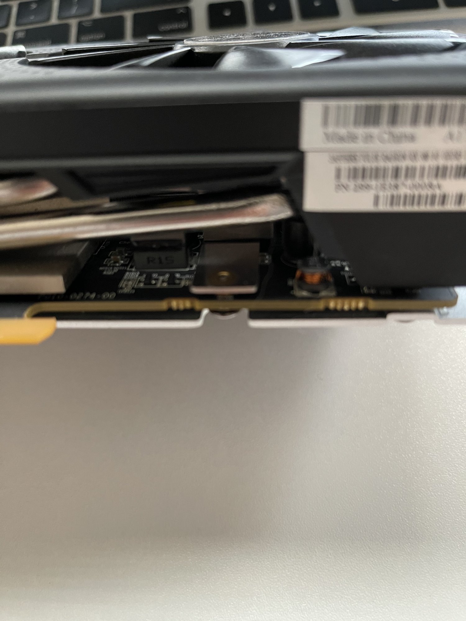

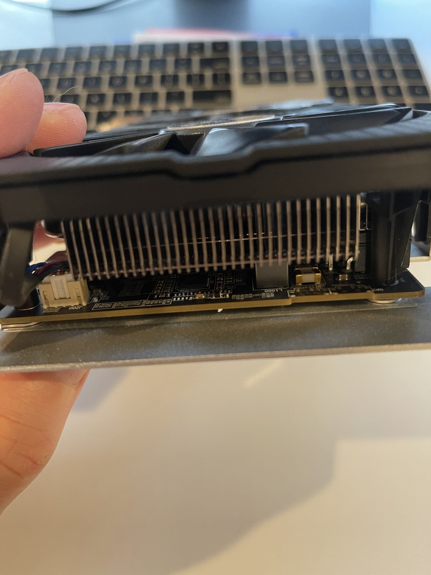

I don’t not see a rom switch.

here is a pic of the video card .. maybe you see something I don’t.

No manual either.
