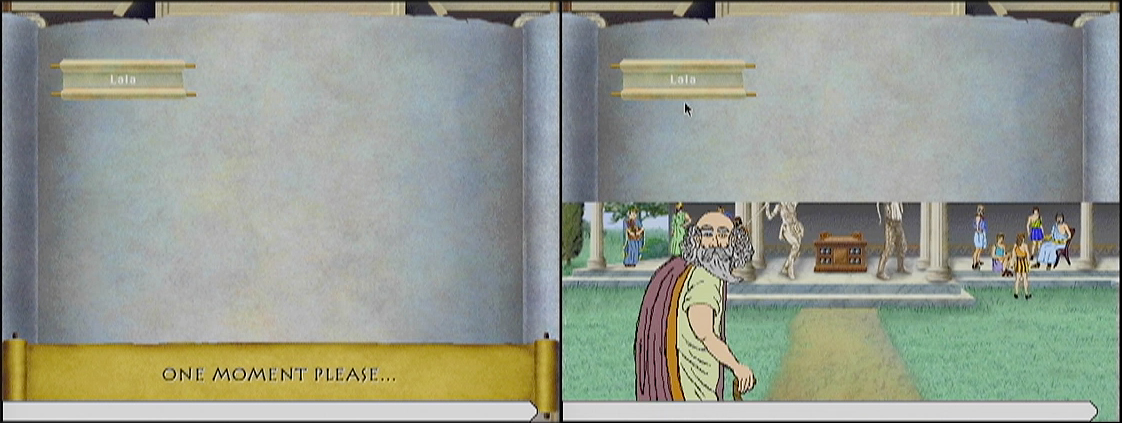

On Ebay, I bought a used PowerBook Pismo G3 laptop to run old pre-OSX games. It seems to work wonderfully however I encountered an issue with the second display output. This problem is present both when using VGA and S-Video.

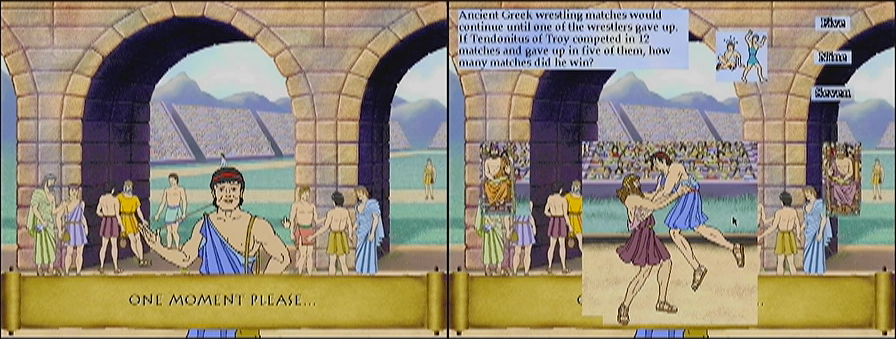

It's hard to explain so I've included two comparison screenshots below, but when the image on the screen needs to change/be updated, only portions of the image do so. The image to the right shows the problem.
I'd like to stress that this ONLY happens on the second display. The built-in monitor shows the game as it is meant to be.
I grew up on PC and this is my first experience with OS9 so forgive me if there's an easy fix for this, I just don't know it.
(Apologies if something is unclear or poorly written in the text. I had a better post on another site but they decided to delete it for some reason... >.>)

Hi, thanks for your reply! And sorry for the late response.
Well for this capture, it's plugged into an Elgato HD capture card via S-Video, so aside from changing the resolution on the laptop there's not much I can do I don't think.
And in regard to the LCD TV, the only options I can find are the standard color correction, screen stretching, etc.
The Laptop recognizes the TV plugged in and I can change the output resolution and Hz. But other than what is on the laptop, there don't seem to be options on either the capture card or the TV.
Edit: I also just tried using a "Sewell PC to TV converter" (VGA -> RCA) and while the picture looks a good deal better, same problem.

I think that what you may be running into is a hardware limitation of the GPU in the Pismo. The desktop Rage 128(with 16mb VRAM) is actually only capable of driving 1 display. I'm not surprised that the Rage 128 Mobility with 8mb VRAM struggles with running two displays, especially with something at least mildly graphically intensive.
I might suggest moving up to a Titanium Powerbook if you want to run extended/mirrored displays for something like this. In particular, the DVI models get you much better GPUs. The earlier of the two(667mhz or 800mhz) gets you a Radeon 7000 and the later(867mhz/1ghz) get you a Radeon 9000. The 1ghz model also gets you 64mb VRAM.
