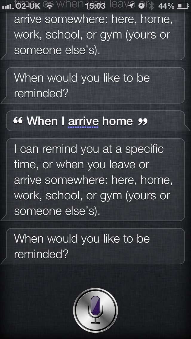

So after having just upgraded from a 3GS to an iPhone 5 I have spent a lot of time playing around on Siri. Very impressed so far but the main thing thats annoying me is I cannot get it to set up location based reminders for me. It just keeps saying, I can remind you when you leave or arrive at home, work, gym etc. But when I say remind me when I leave home he just repeats the message and I keep going in circles.
Any suggestions or is it a bug?
Do you have the locations setup as contacts? I believe for this to work the locations have to be saved as contacts. If you do a search on maps and find the location(s), save them to contacts and it should work. I have a 4 (no Siri) and I can manually setup location based reminders that way. I'm sure Siri can do it too.

Thank you sooooo much , this was driving me absolutely crazy !!!!!
This is so stupid though , i typed in my work on my contacts and tagged it as such . And maps recognised it . But siri couldnt do location based reminders.
But if you drop a pin on the map and add it to contacts it works . So weird all the info exactly the same but until you do it exactly how Ios 6 wants doesnt work
Hi, I am trying to resolve this issue myself - everything worked fine before upgrading to iOS6, and now I get this looping message each time I try to set a location-based reminder via Siri - I can do it perfectly well manually with the reminders app (it recognises 'home' and 'work' there) but Siri doesn't work with this. The two addresses were added via the Map app (pins dropped and linked to my contact as 'home' and 'work'). Interestingly, if I delete the locations and re-create them, Siri will work with them immediately, but after a short period (long enough to test with one reminder, delete it and try another), it stopped again!

I have the exact same problem as the original poster. So far, I am only attempting to set a reminder for when I get home. I have identified myself in the contact list and set my home address by using a pinpoint in mapper to add the location as my home to my contact information. I am able to set a location-based reminder if I do so manually in Reminders. If I ask Siri to do so, I get the same cyclical problem shown originally.

i found out that i have to say "when i get to my HOUSE"
i tried to tell her "when i get home" and she would ask "which home: home depot, XXX or home depot XXX" that i have in my contacts....
if i tell her house.... it works!
i do have my addy/contact info all entered and correct...
Hmm I say "Remind me to do xyz when I get home" and it works. Initially it made me a create a contact for myself where I had put in the home address.
