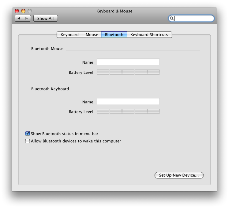

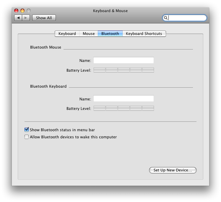

Make sure you have the Allow bluetooth devices to wake this computer option unchecked! Pic below.
