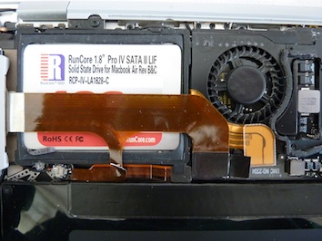

What tape did you use and what do you mean by taping it?
There doesn't appear to be any place to add tape. Which end did you tape? Could you please explain taping the LIF with a little more detail? Thanks.

I taped where the LIF cable connects to the Runcore SSD. In the photos in the other Runcore SSD thread, it shows the little black flip clip to lock the LIF cable in place into the Runcore, but mine never had that. Therefore it was loose. Since I had tape from the original SSD, I just removed it from original and placed it on the Runcore SSD. In fact, the original LIF cable was taped to the original SSD. I removed that piece of tape and swapped it right into position on the new tape. I wondered if my black closable LIF clip on the drive was originally
Good luck with it. I hope that helps out. Mine was 100% corrected instantly. It was so relieving at the time.

Well, I hadn't used tape when installing the SSD. It is still on the original drive.
So, I tried Scottsdale's suggestion. I used electrical tape and will report back on the results.
Perhaps the tape prevents a short?

True. I didn't know there was a clip ("flap") until I saw a photo of someone else's drive. It seemed obvious that it should have one when I opened it and looked at it. The LIF cable seemed like it didn't lock into place well so tape was the thing mine definitely needed. In all honesty, a nice instruction set and some photos would do this company's buyers a great service. I don't understand why they don't include both an instruction sheet and a link to photo/video instructions on their website.
Drive is still amazing.

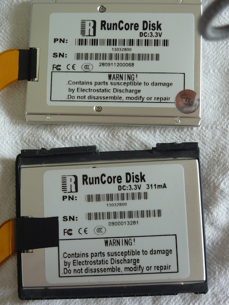

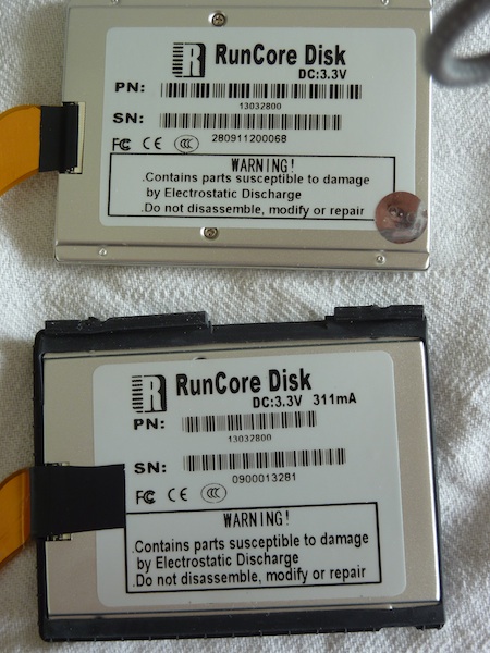

Here are my recent RunCore SSD experiences, perhaps there is here a piece to the puzzle that might help someone figure out why some of us are experiencing problems.
I purchased a 128G Runcore SSD back in Nov 2009 but did not install it in my 1.86 Rev C Air until March 2010. The SSD would crash several times a week most commonly soon after waking from sleep. Of course the crashes did not occur with the stock 120G HD (frankly I could live with the HD as it was not that slow!). I updated the firmware from 15xx to 19xx and reinstalled the OS, neither corrected the crashing problem.
I tried adding tape as suggested by Scottsdale but that did not seem to help (note black electrical tape in picture below)
For some illogical reason I purchased a second 128G Runcore SSD at the time of installing the first. In April I installed the new SSD with Scottsdale modification and updated the firmware from 18xx to 19xx. So far the new SSD seems to be much better than the original. There have been two crashes in 2 weeks but not quite the same circumstances as before so I am happier but not yet ready to declare success.
The two drives are shown below, the older drive is on the bottom.
