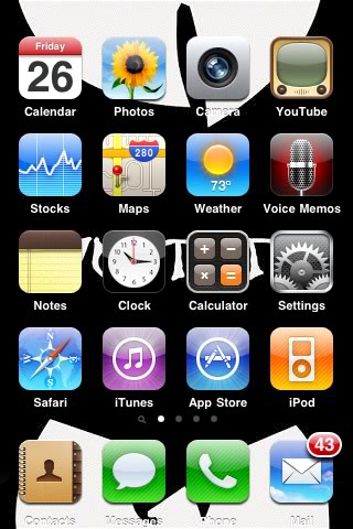

I noticed this today,my status bar disappears for no reason and comes back if I lock the phone or just appears again randomly. Has anyone else had this problem?

UPDATE: For some reason, "springboard crashed", so the phone was in Safe Mode. Anyone encounter this issue?

Never mind, it was my (noob) mistake. I had the "solid status bar" checked in Winterboard. :D
