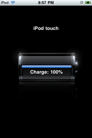

I've attached a screenshot of what it should look like in the end.
