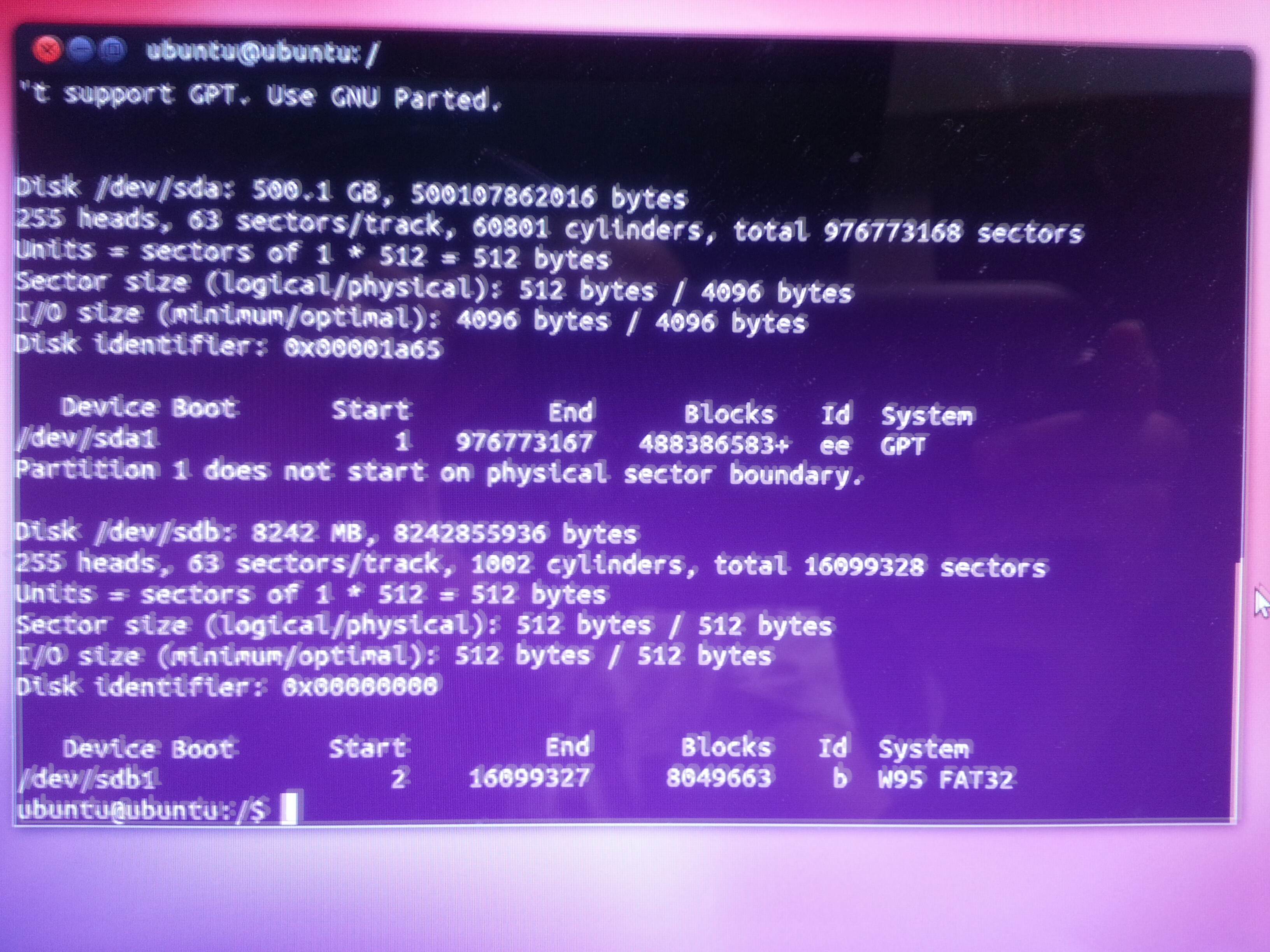

No that didn't work. I wrote the recommended partition table using gptsync and restarted my computer and still didn't see windows when I held down the options key. One thing I think you should look at is the results that I got from using fdisk -l running Ubuntu. Its attached below.

That's really odd. I'm kind of thinking it's beyond repair, unfortunately I've had this same type of thing happen to me before as well and I wasnt able to fix it. I take it Ubuntu can't see the drive to get your files off of it?

If you use Bootcamp any subsequent partition resizing is unsupported. This may well result in mismatched mbr/gpt partition tables.
The system may remain usable and everything may seem fine.
However, if subsequently an OSX installer is run it will try to repair the mbr/gpt entries and it will get one or more wrong.
The system has most likely lost the start and/or end sector of your Bootcamp partition. Consequently it can't boot it.
It may be possible to repair it but it may be a better option to wipe the disc and start again (getting partition sizes correct this time - I had to).
There are posts on here by murphychris which explain what possible remedies there are. I suggest you have a search for those and see what you think.
