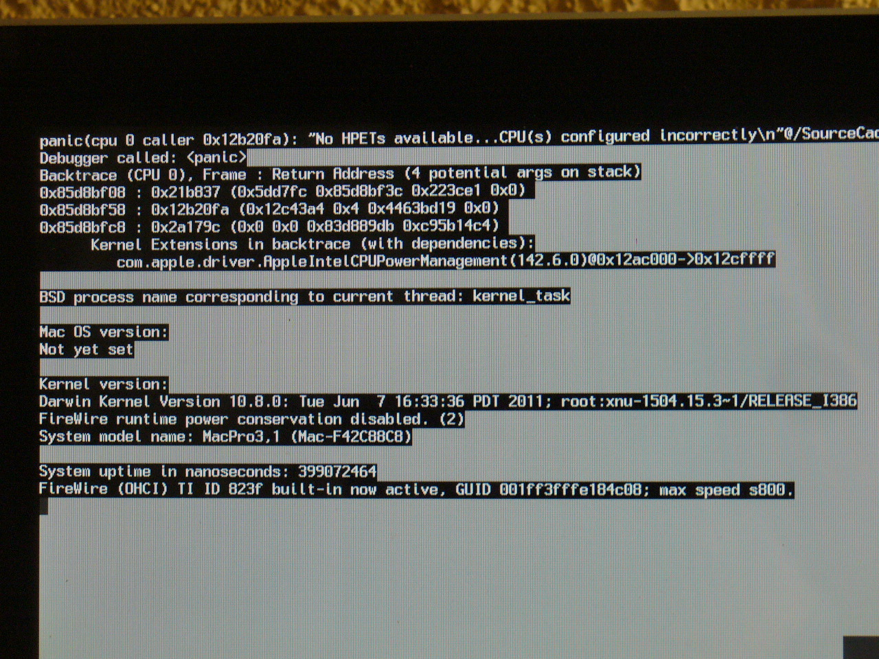

I have tested both single CPU.
Both CPU in the top CPU slot generate a kernel panic (see picture).
Both CPU in the lower CPU slot produce a black screen.
can someone help. What does this kernel panic?

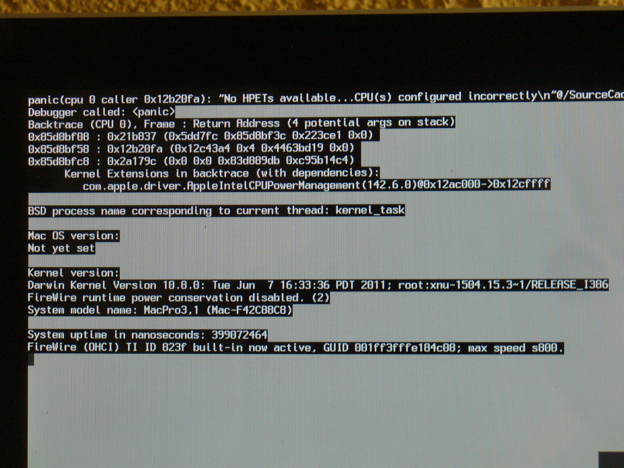

here the picture

suggest you put the other chips back in to insure there is nothing wrong. Those processors should work. Starting to wonder if you bought a bad set of chips. Do you know anyone with a harpertown rig to make sure the chips are good?
I am no expert in this myself but reading the kernel panic I thought about resetting the PMU/PRAM or whatever. Do you need to do it and have you done it?
Upon further investigation, I found that this is a fairly common problem in the Hackintosh community. Their fix has been to move or rename the file /System/Library/Extensions/AppleIntelCPUPowerManagement.kext
Apparently this solution has worked on Macs with the same problem.
Obviously I don't take responsibility for what happens but I'd suggest you try boot your HD on another Mac and do the above change and try again.
Another thing to try in eliminating the problem is in fact removing the HD and trying to boot from an installation CD. If you get the same problem with the HD disconnected the solution above will make no difference.
If you can't even get to a boot disk the problem is in hardware or firmware settings.
Then I would try resetting all the acronyms you can think of, SMC/PRAM/PMU
Hope that helps.
