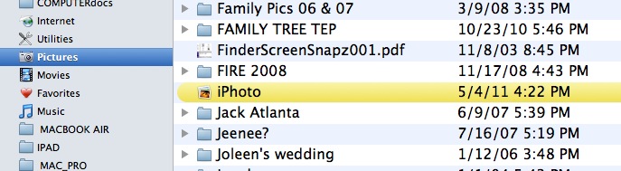

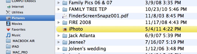

For your Iphoto application to recognize its original Library after your Migration is complete. Check in on your new computer, inside your "Pictures" folder for the actual "iPhoto Library". It will look something like this:
If by chance, you do not see it, then take it manually off of the original Mac's Picture folder.
When you start iPhoto, hold down the OPTION KEY, keeping it down until you are given the option to "create or choose" an iPhoto Library. Then select that file that is in your Pictures folder, and your Albums should show up just fine.
