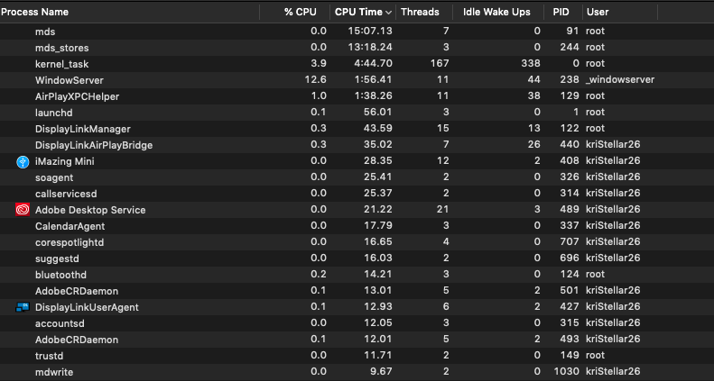

I am going to attach a screen shot of the top processes for CPU time. Does this tell you anything?

Yes next to nothing taking any of the processor, at ~12% the WindowServer is the same as mine with dozens of windows open. I think I am out of ideas here there appears to be nothing running taking a lot of the CPU to heat it up. You may be back to your original idea of going back to the old OS.
