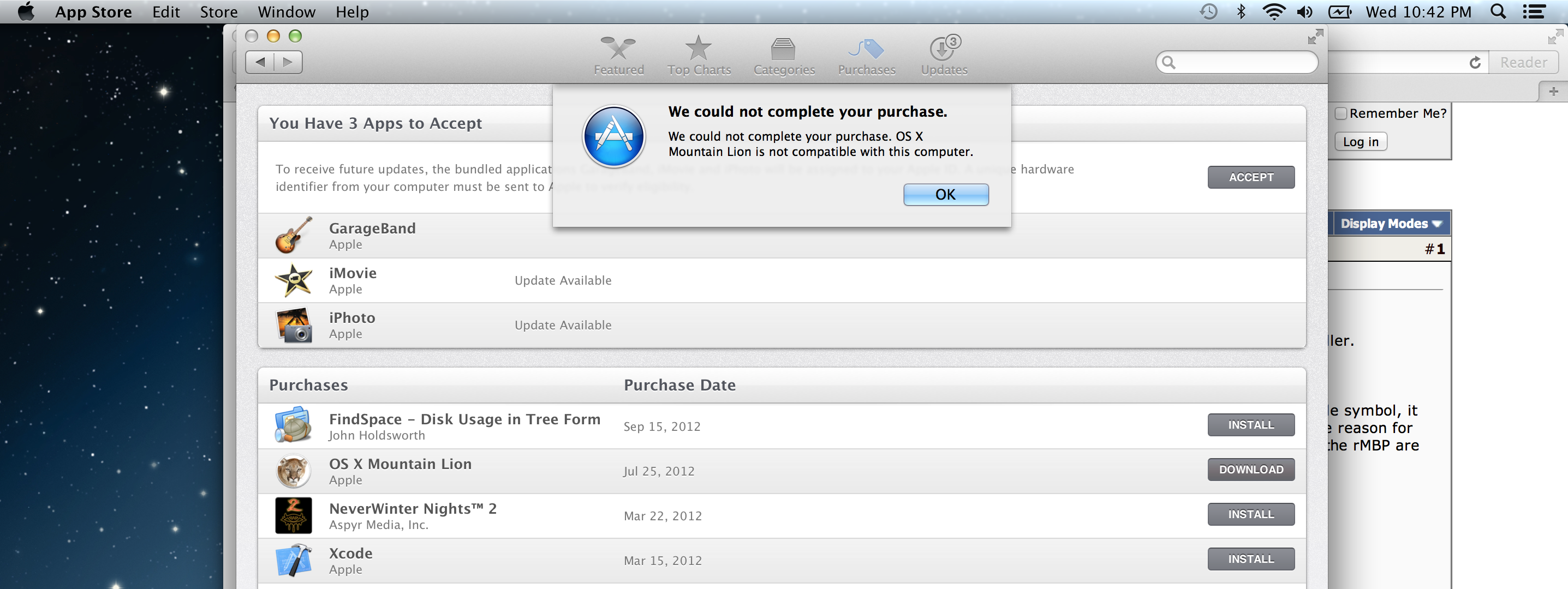

I tried downloading Mountain Lion from the App Store using the original SSD and I get this message: "We could not complete your purchase. OS X Mountain Lion is not compatible with this computer." How can this be?

I found my answer here:
https://discussions.apple.com/thread/4539877?start=0&tstart=0
Your computer shipped with a special build that is currently not available from the Mac app store to reinstall OS X. That's why you're getting that error. Apple is aware of the issue & working on an update. You will not be able to reinstall until this update is released. You can call AppleCare...they are aware of the issue & may replace your computer.
That's a bummer. If I can't get Command-R to work, not sure how I'll use the larger SSD.
