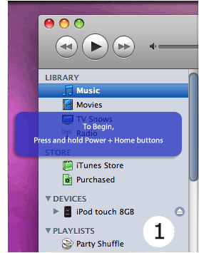

    Please follow the following image:
    [​IMG]
    Then try shift-click and select your firmware. It should work.

    OKk I'll try this and see how it goes..
    Many thanks!
    Fingures crossed i've been trying for ages!
