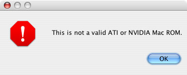

Today, I am actually putting together an old PC for games that were not released for Mac. I figured the X800 would be a good fit. The problem is, it has a non-working Mac rom of some type on it. Graphiccelator refuses to load the original PC rom that I backed up.
Obviously this is a PC rom. I guess the developer never thought anyone would try to use it to restore their original rom?

there is a specific "install PC ROM into ATI Flasher" option in graphiccelerator in one of the drop down menus
I have used this very successfully to flash PC ROMs to a number of my ATI Video cards
