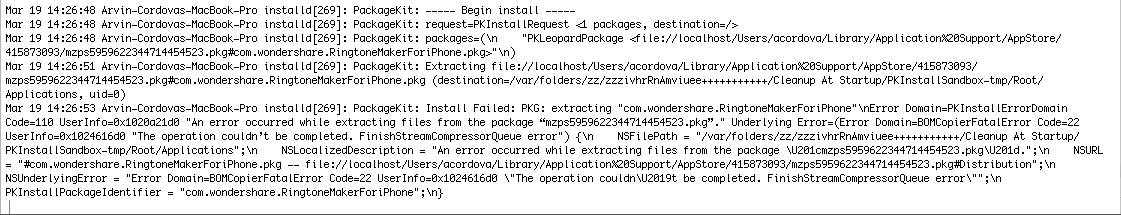

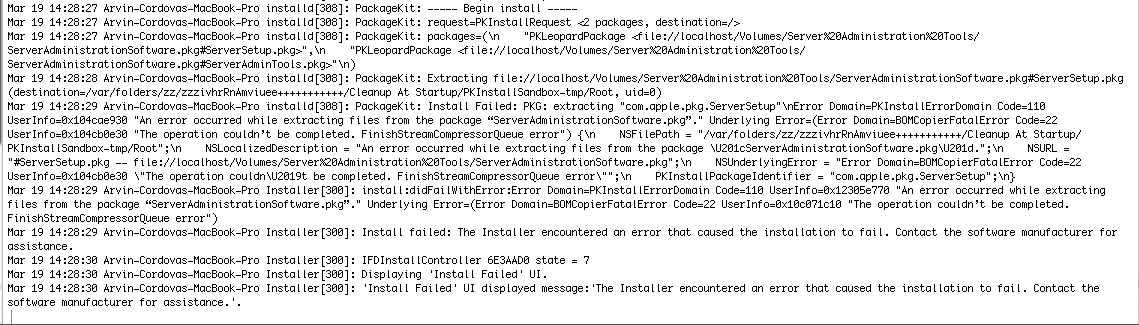

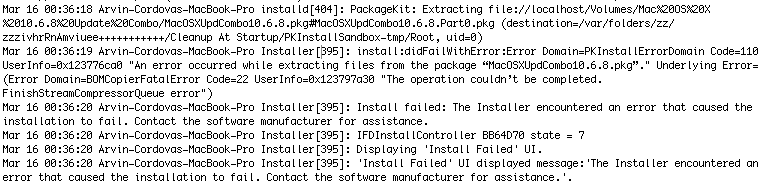

Sorry, I should've mentioned that I have gone through both the Repair Disk and the Repair Permissions processes. I tried again in the last hour and everything checks out. I've attached screenshots of the console messages when trying to update, trying to install an app, and also trying to install from a .pkg file.

Have you got any installers on a shop-bought disk that you can try? Or an archived installer that you know has worked in the past?
My thought is: is it a problem with downloading large files successfully, or is it a problem with installing?
To me, the Console logs suggest that there's a problem with the file that has been downloaded.
Just tried uninstalling and reinstalling a software that I still had the .pkg file for. It installed fine. So I guess my downloads are getting corrupted. Again, I've tried Software Update on other networks with the same result though.
