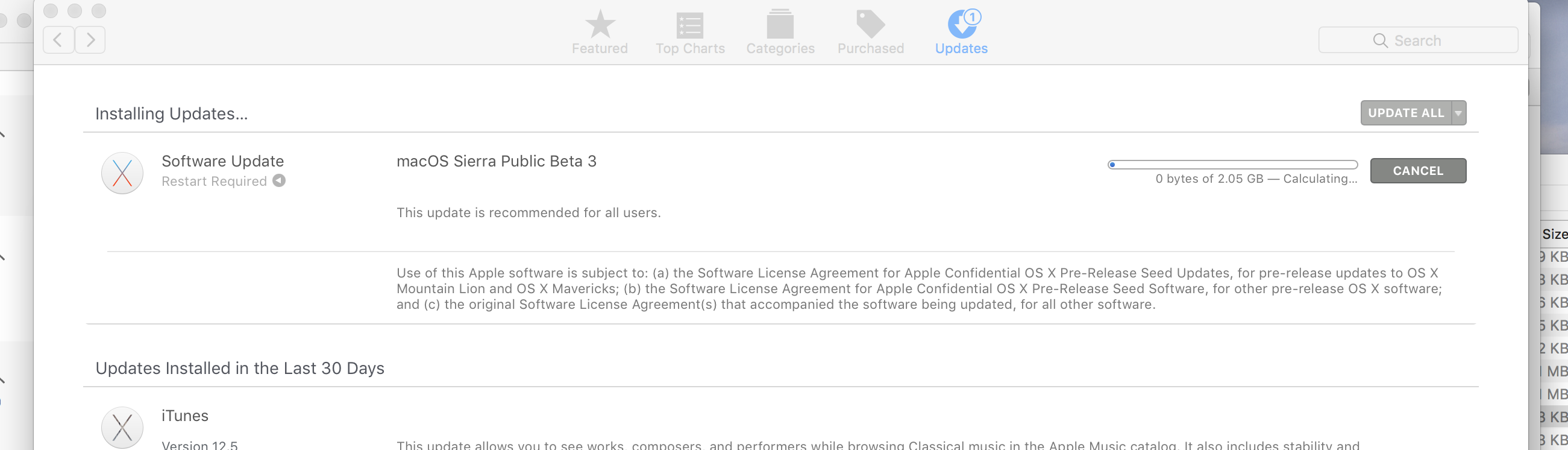

I had previously configured the App Store to download updates but wait for me to install them. It looks like it successfully downloaded the macOS Sierra Public Beta 3 update to /Library/Updates/031-69393/ and then the App Store requested that I install it. When I said yes to install, App Store went to Installing but then hangs at "0 bytes of 2.05 GB -- Calculating.."

I was finally successful but can't recommend an exact procedure. I repeated deleting all files in /Library/Updates and rebooting. Eventually it worked, downloaded/installed Public Beta 3 after having the same problem you had (mine stopped at 151MB for some strange reason).
I updated 3 systems. No problems updating two Macbooc Airs (late 2011 and early 2014). The problem occurred with my late 2011 Mac Mini. Had similar problems updating to macOS Sierra Public Beta 2 a few weeks ago on the Mac Mini only. This was a time-consuming and unpleasant experience.
