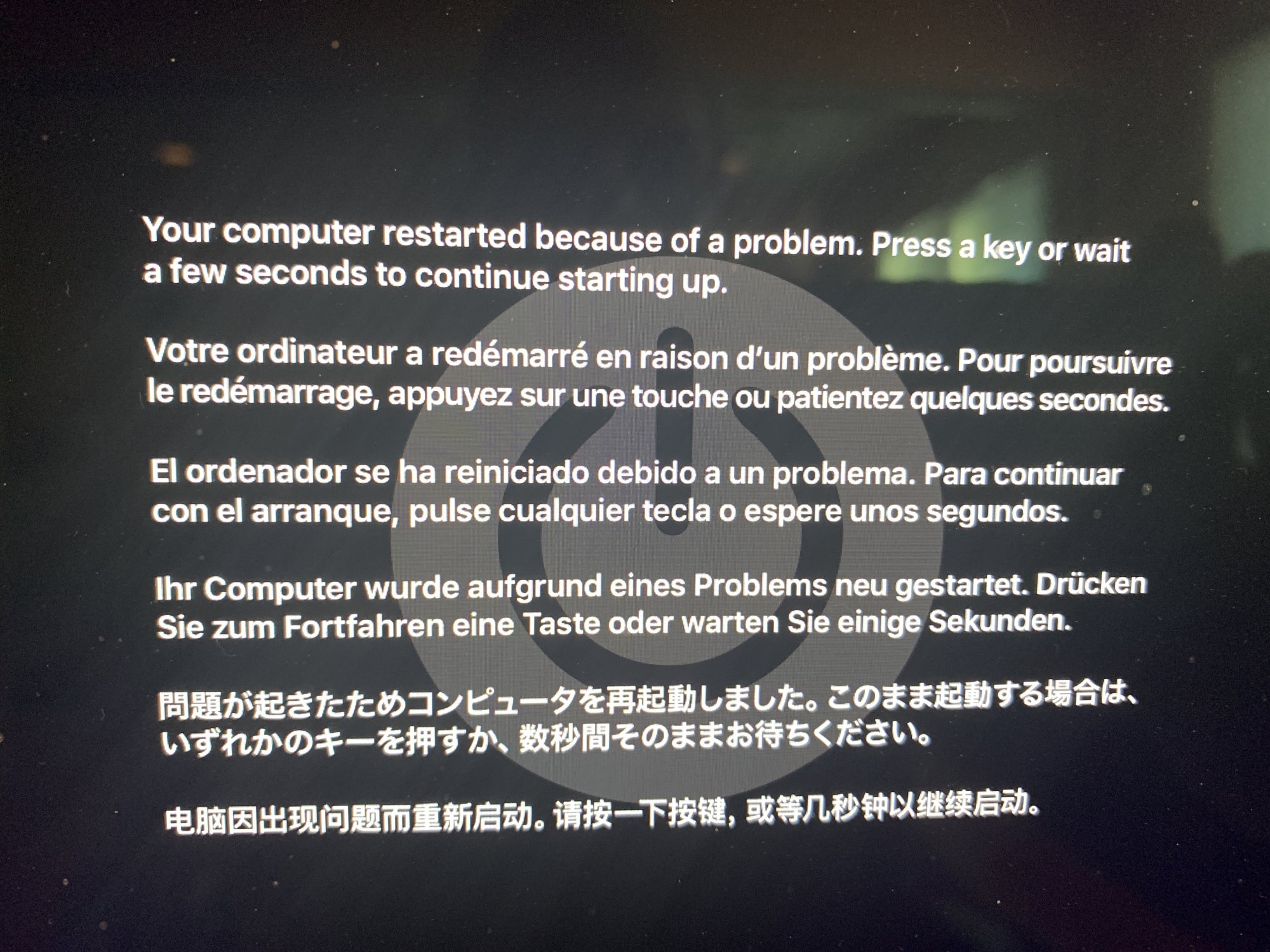

I am trying to install the latest version of Monterey on my 2015 iMac, which is booted from an External OWC SSD running Big Sur.
Monterey downloaded and was proceeding through the normal, multiple restarts when I got the screen pictured below.
Knowing that sometimes these things resolve themselves, I let the computer restart three times, but each time it delivered the same warning so I shut it down manually after the third one.
Any suggestions? I have a good TM backup (two in fact).

No joy. A reinstall of Monterey produced the same, "Your computer restarted because of a problem".
On hold for your next suggestion.

Threads not dead...yet. OWC finally piped up. Their support is super busy and they are getting back to me but slowly.
Here are my exchanges with them so far:
22 December - from OWC:
Looking into this further, the firmware is updated properly on the computer, however let me take a look at the information a little more closely. Can you send me a copy of your System Report? To do this, go to the Apple logo in the upper left hand corner and select About This Mac. From there click on System Report. Once opened, click on File and select Save. Please be sure to save them as a .spx file.
23 December - to OWC
The iMac has been problem free, running Big Sur, booted from the external OWC SSD, ever since Big Sur came out last year.
My first effort to install Monterey was to run Software Update from Sys Prefs while booted to Big Sur and that failed dismally.
I then booted up in Recovery Mode, erased the OWC SSD, formatted it at APFS, then installed Monterey from Recovery Mode.
Again, ended up with the multi-language alert.

P R O B L E M S O L V E D !!!
Some Level 10 dude, named rkaufman, on the Apple Support site came up with the answer.
Just follow the instructions at this website:
Here are the steps.
The problem was, I believe, that my external SSD was formatted as APFS, whereas the instructions at the website say to - Give the external hard drive a suitable name and select “Mac OS Extended (Journaled)” as the drive’s format and “GUID Partition Map” as the drive’s partition scheme. Who would have thought it?
• Connect the external hard drive to your Mac.
• Launch Disk Utility (located in Applications -> Utilities).
• Click View and choose the Show all devices option.
• Select your external hard drive (not just a single partition).
• Click Erase.
• Give the external hard drive a suitable name and select “Mac OS Extended (Journaled)” as the drive’s format and “GUID Partition Map” as the drive’s partition scheme.
• Click Erase and wait for Disk Utility to prepare your external drive for you.
