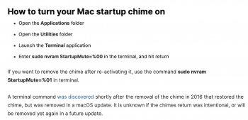

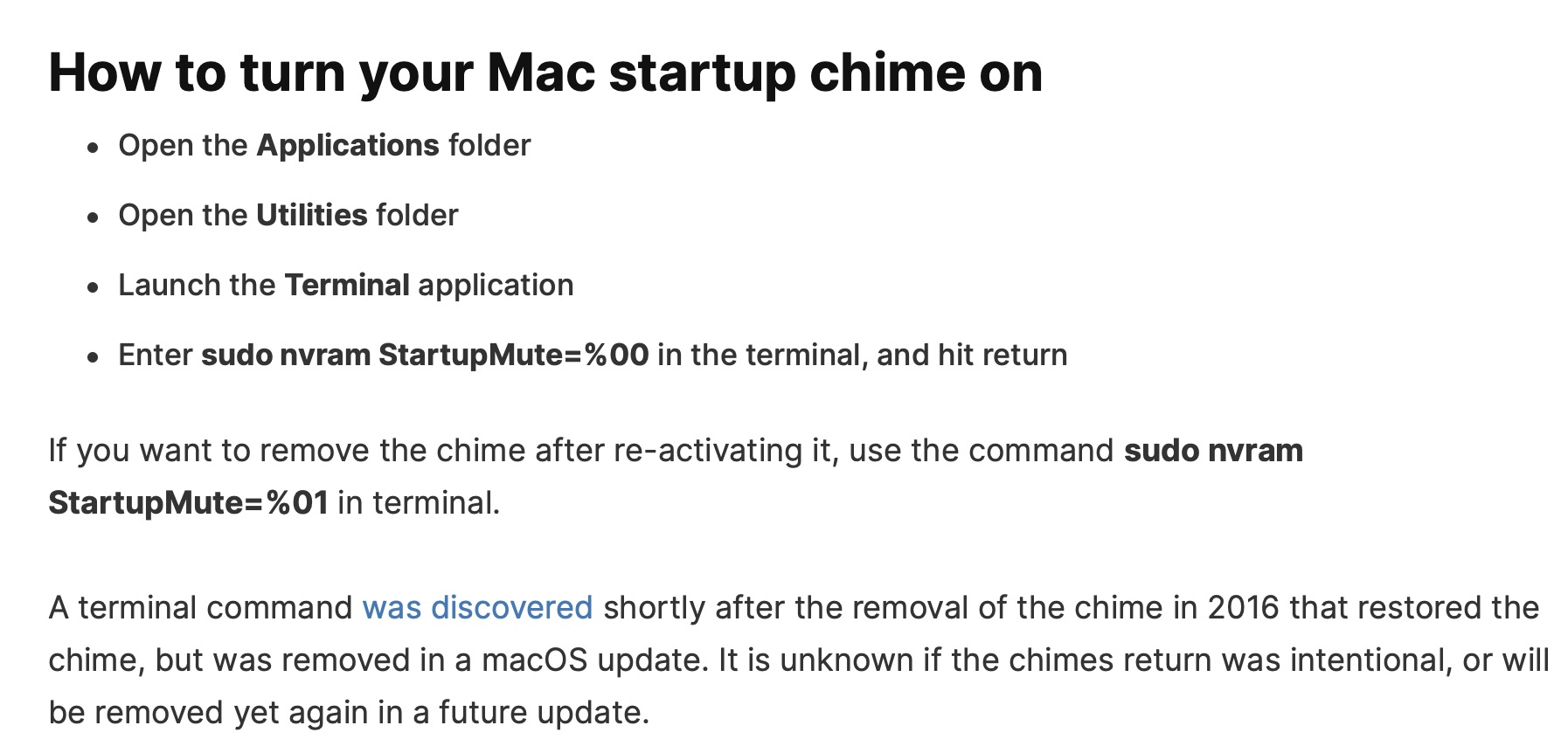

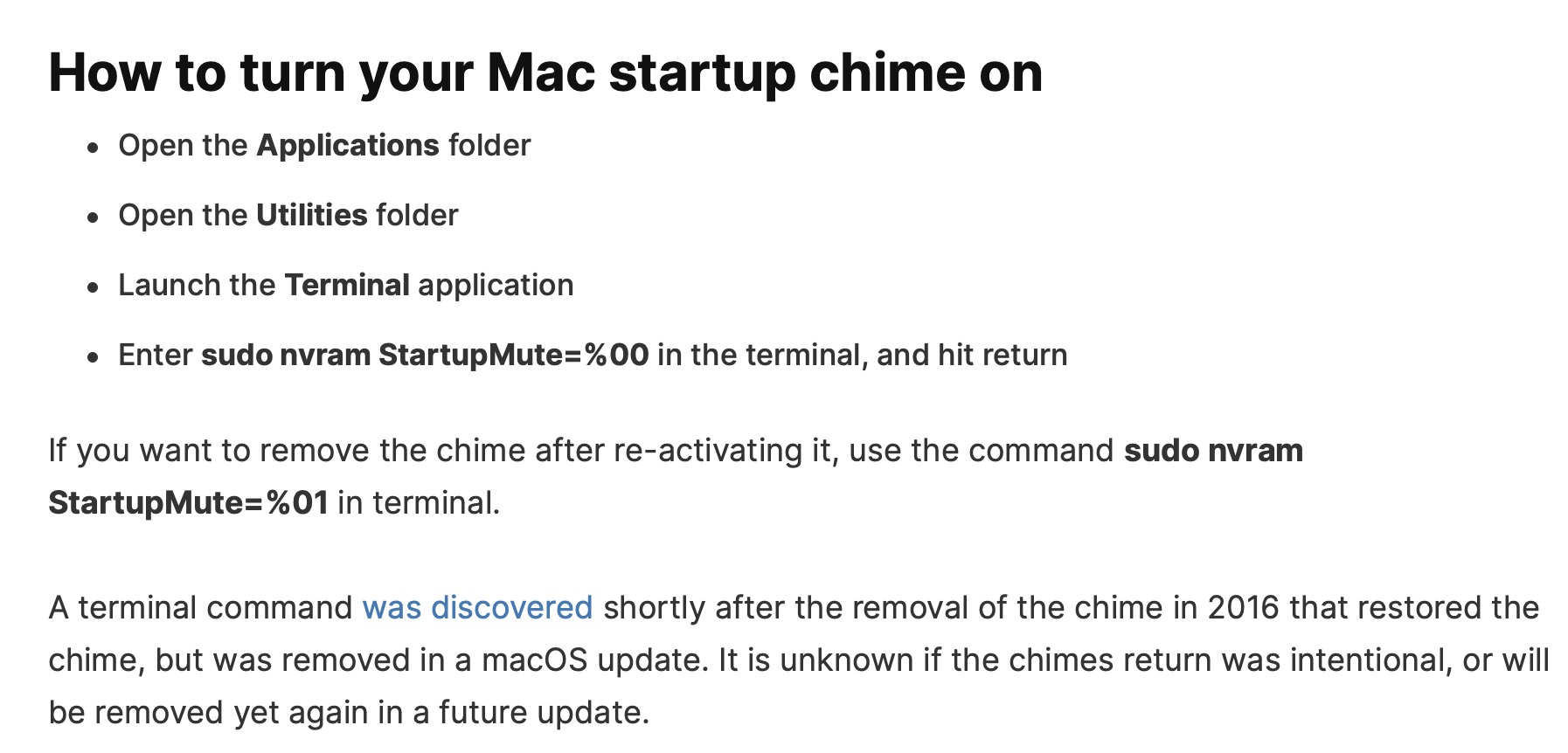

You guys were spot on. I just had to wait longer. I also set up the iMac to chime again when it was turned on because with the unit resting on its screen, I couldn't tell what was happening. So, now I have 64 GB of RAM operating at the proper speed. Thanks! Now, why isn't there an applet to increase the size of the font in the Safari toolbars? 🙂
This is what I used to get the chime back...
