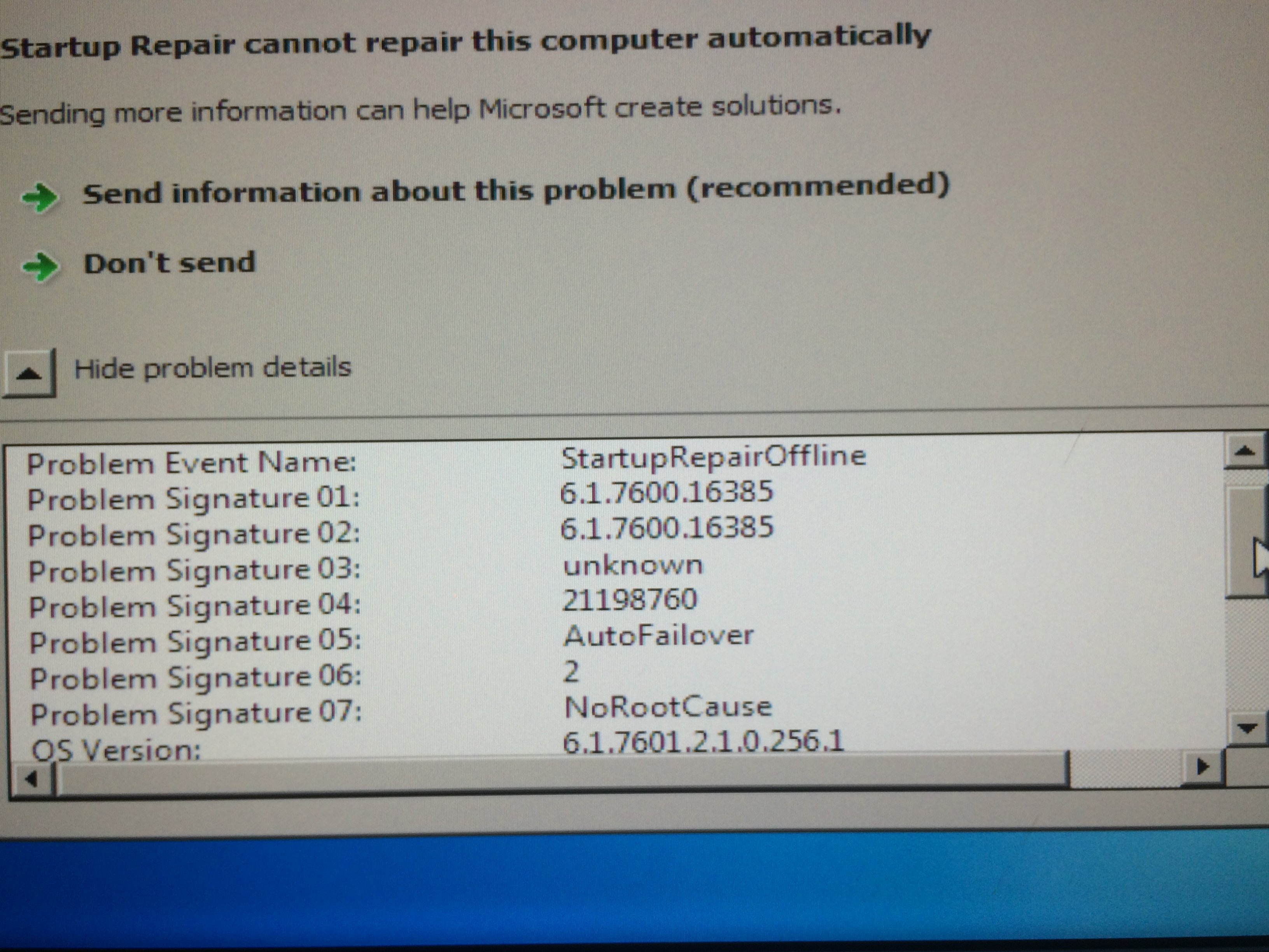

Ok so I installed Windows 64 bit to my boot camp drive using VMware Fusion. It boots in fusion fine, but when I try to boot the machine off the drive it freezes while booting and the system reboots.
[doublepost=1457048698][/doublepost]Oh and my specs are: Intel Xeon x5355 8 core, 11 GB of ram(4x2gb 2x1gb 2x512mb), ATI Radeon HD 5770 Graphics.
Here's a picture in Windows recovery:

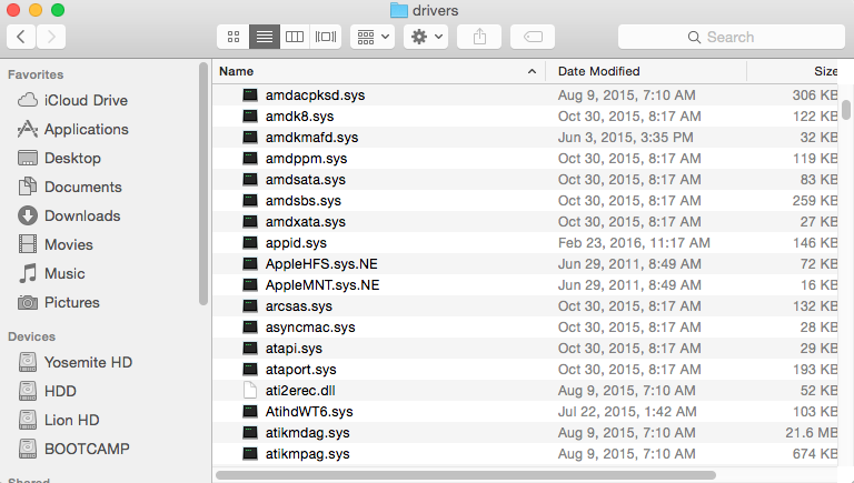

Also, on C:/Windows/System32/drivers i renamed AppleHFS.sys and AppleMNT.sys drivers (so they won't load) because I've read that they tend to bring up "blues screen of death" on Win boot... Don't know if it still does or not, haven't test it myself.
