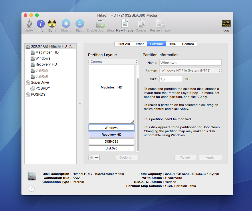

I think the problem has to do with the boot.ini files. I've tried repairing the HD partition map, etc, in Disk Utility.

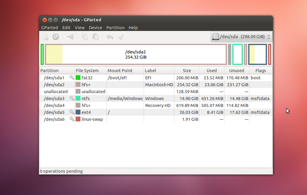

This is the basic layout of the partitions in order:
EFI; Mac OS X partition (HFS+); Windows partition (NTFS); Recovery partition (HFS); Ubuntu partition (ext4); Ubuntu Swap partition (Linux Swap).

  • Screenshot from 2015-02-26 17:30:48.png
