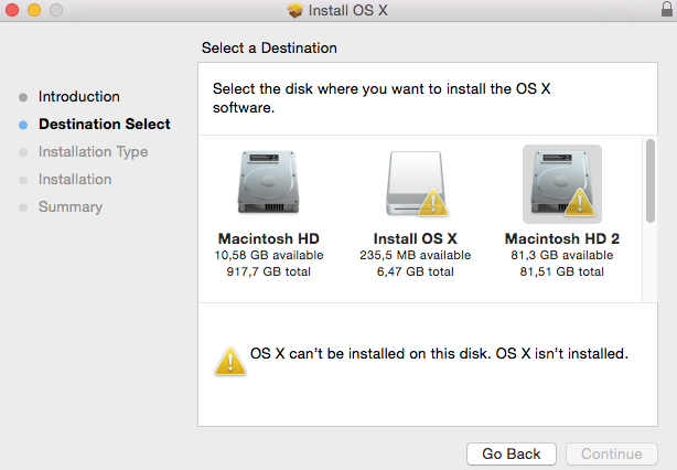

Hi all! Trying to partition my hard disk here but running into problems...
I'm running Yosemite 10.10.5 on a 27-inch, late 2013 iMac, 1TB of disk
I've decided to make a small partition on my disk and am trying to install Catalina on that. My Mac can run up to Catalina 10.15.7
But I'm running into problem after problem!
I created the partition, that went fine, its just over 80GB in size.
My plan, following this YouTube tutorial:
https://www.youtube.com/watch?v=C3R2xTPLhgc
was to create the partition, download the Catalina OS, then choose Hard Disk 2 as destination and install it there.
I quickly found out that Catalina was never released as a .dmg file so that plan fell through.
Instead I downloaded El Capitan from the Internet Archive and thought I'd try doing my plan in stages.
But when I try to install El Capitan on HD2 I'm told "OSX can't be installed on this disk. OSX isn't installed"
I don't get it? What did I miss?
How can I have created a partition with no OSX? What do I need to do next?
Very grateful for any tips!
I would recommend you download it from this apple.com support article which links to a bunch of macOS installers.
This is because, despite the naming, what you're installing is not OS X/macOS, but rather the OS X/macOS Installer, app which you launch which will then guide you through the OS installation process. This is an unfortunate side-effect of how Apple packaged these installers. You need to first install the installer onto a disk that runs macOS. You can also use a tool like pacifist to manually extract the installer, but this is tedious because the installer is not simple.
Reactions: Nermal and momech
