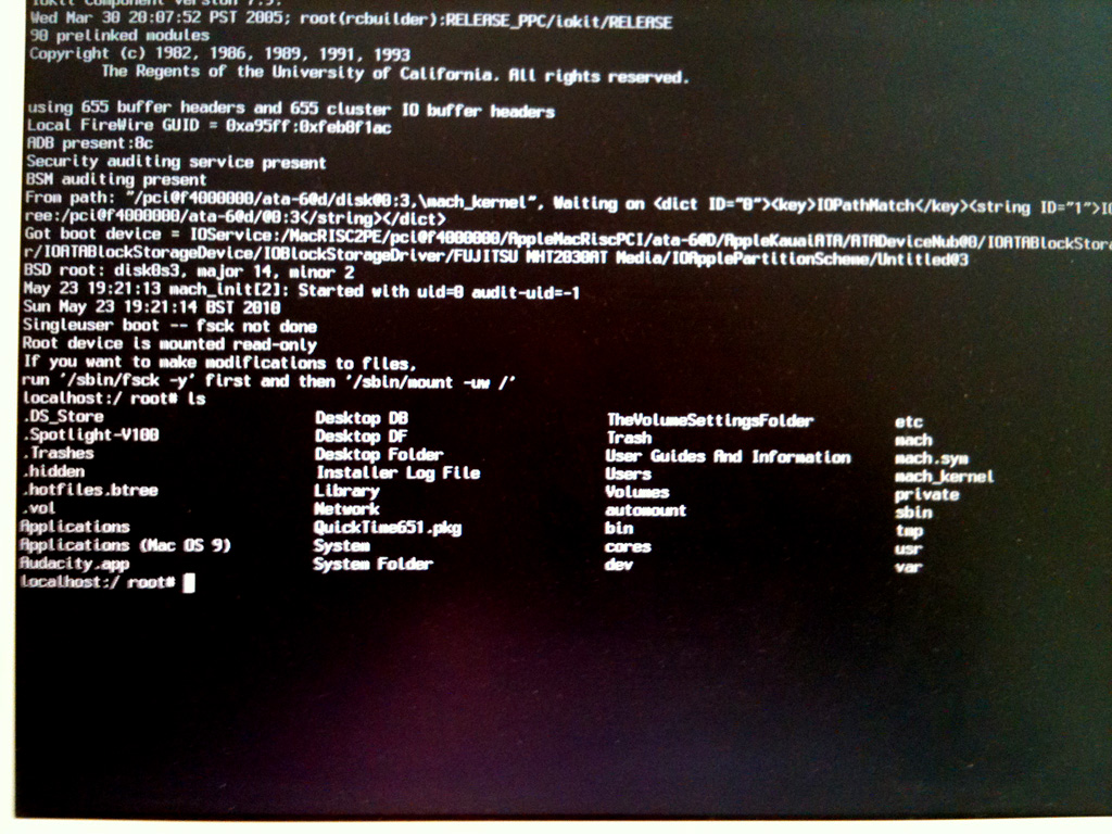

I've attached a screenshot of the "ls" command result

Hmmm.... looks like the symbolic links ARE intact.
Can you boot the machine as normal? What is the result?
EDIT: in other words, are you still at least able to log into a non-admin account and what is the name of that account?

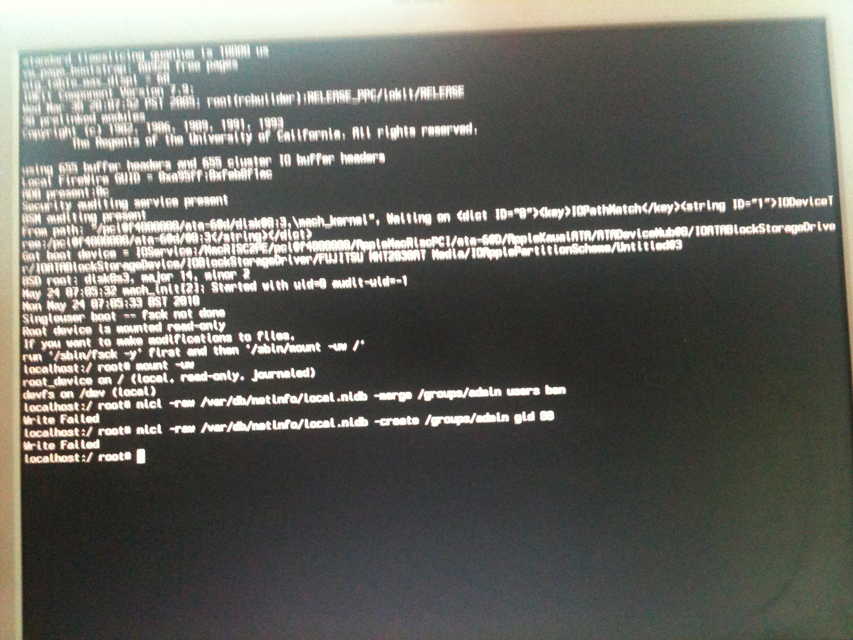

I've attached another screenshot for your info - sorry about the quality
As you can see, the general message is "Write Failed"
You can probably point out something very stupid that I've done wrong, if not thanks for your help anyway - I'll recommend that my friend picks up an install disk on ebay.
Mof
Yup, you missed the trailing slash when mounting the volume which made it read-only.
IE:
/sbin/mount -uw /
MacTech68 - I thank you from the bottom of my heart for your patience and genius - new account created and that particular problem now solved.
