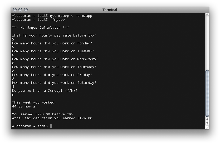

Compiles and runs just fine.
Yes it compiles and runs perfectly for me too but it's when I try and send it to others I get permission denied. That's 2 friends reporting this so going to read the thread on how to change the permissions.

    char ch;
    while (1) {
        fpurge(stdin);
        printf("Do you work on a Sunday? (Y/N)?\n");
        ch = getchar();
        if (ch == 'Y' || ch == 'y') {
            return 1;
        } else if (ch == 'N' || ch == 'n') {
            return 0;
*note the workedSunday() function doesn't bail if they enter a non Y/N answer. In practice you might want to write a counter into it to let the user out if they keep messing up.
Nice rewrite, but I have to throw in that using fpurge() is not recommended because it is not a standard part of the C library, and probably won't work on other systems.
I can't thank you all enough for the work you've done here for me !!! I am just about to learn about functions so it is nice to see how you implemented them into my own app.
I didn't really know what it did, but since it was part of the original I decided to err on the side of caution and keep it rather than simply throwing it away or learning more about it.
