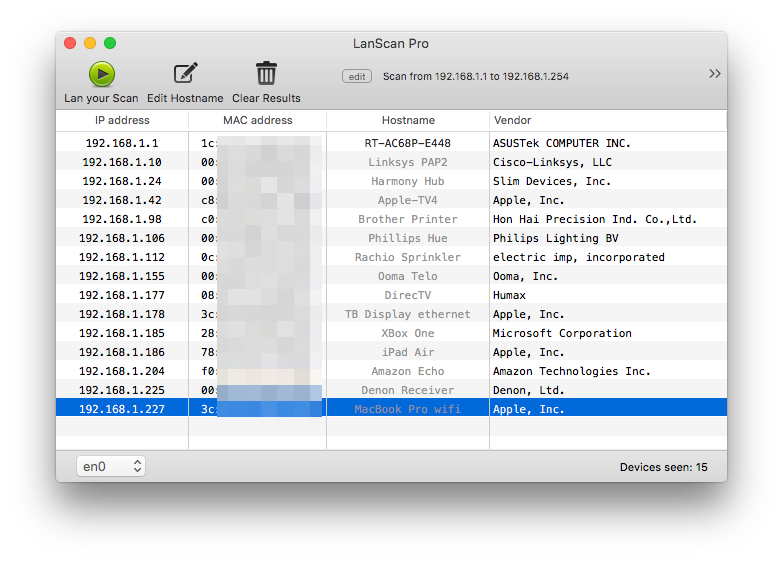

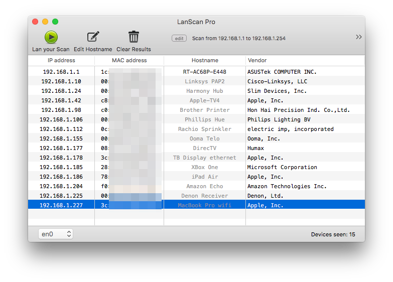

http://www.iwaxx.com/lanscan/
I'm wondering if the other device being run off that extender is preventing it from being seen across the network? Install the free version of Lanscan and run it on both devices to see what both machines can pickup over the internal network.
Like you can see in my screenshot it will show all devices visible on the network from the machine where the app was run. If you cannot see the other machine, no amount of configuration on the Mac will fix this.
