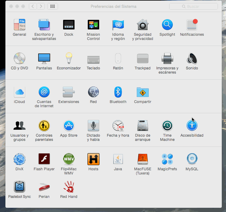

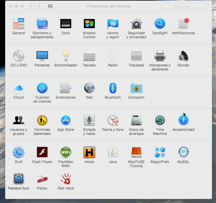

Hello!
I had the same problem and solve it successfully. This is what I did.
Due I have configured my OSX to spanish, I make this animated gif to show you the path.
I really hope you find it useful.
