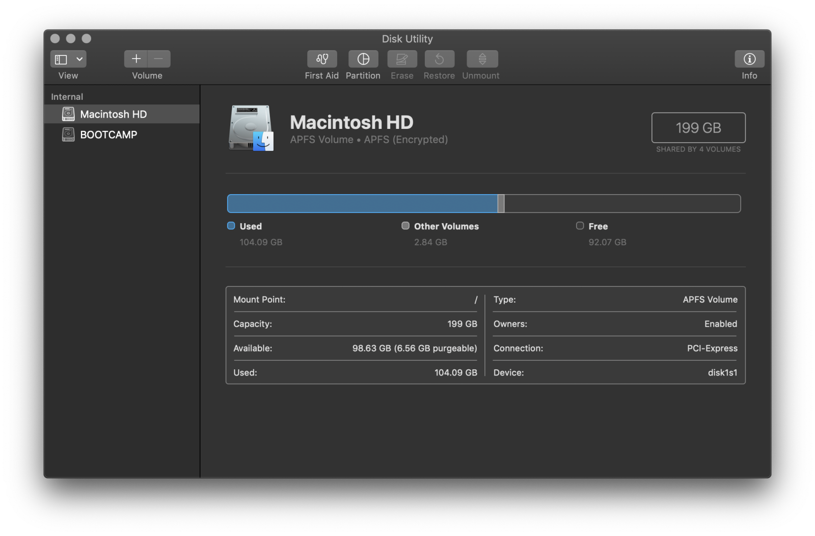

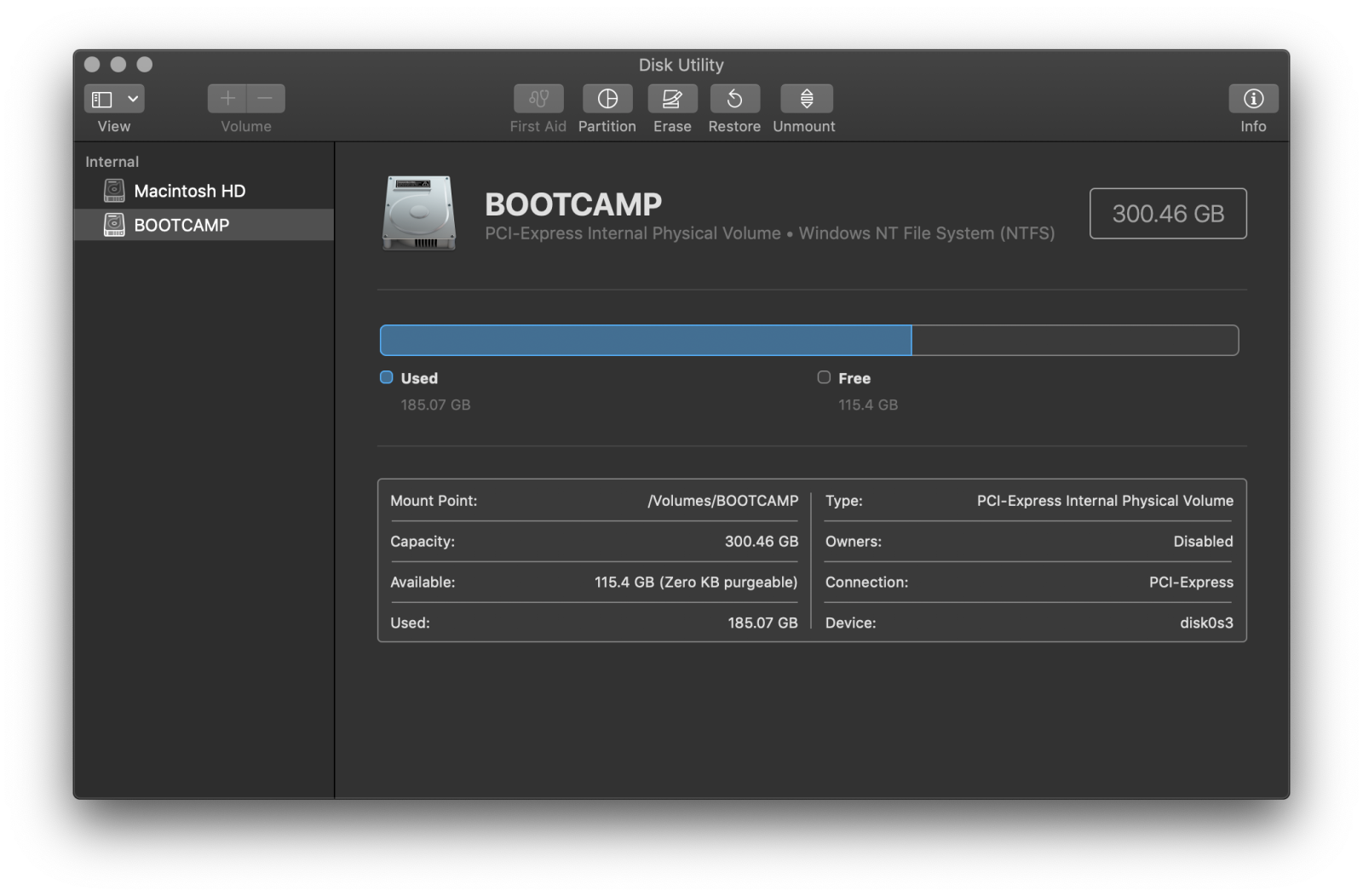

In Disk Utility I can see the following.
Would using Disk Utility to simply delete extending the macOS partition be useful, like this?

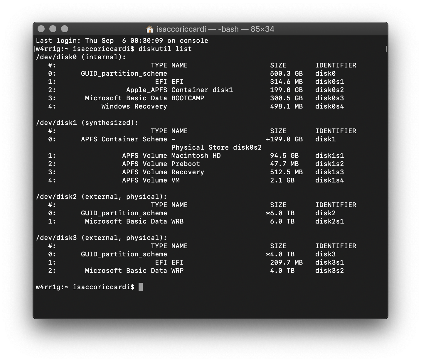

Open terminal and run: diskutil list
Take a screenshot & post here
Here you go! 2 and 3 were copying files so I couldn't disconnect them at the time I took the screenshot...

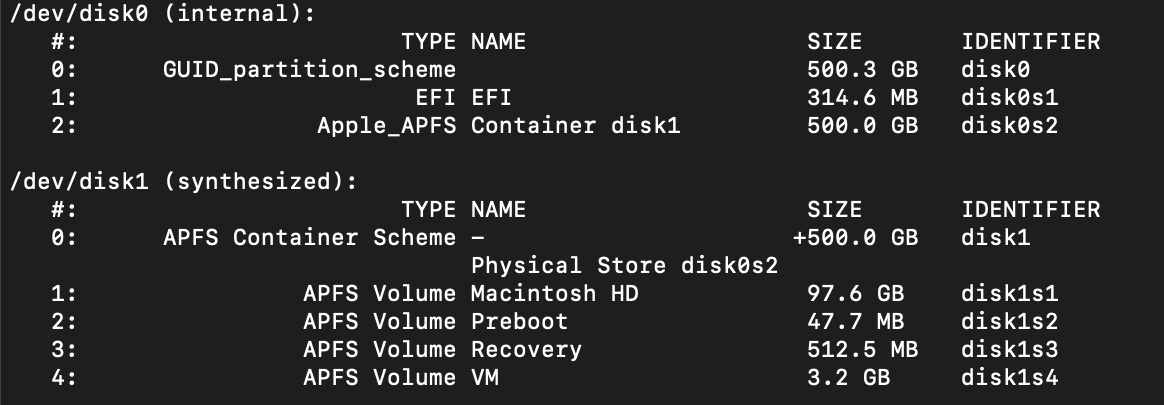

I did what you suggested and it worked, thank you very much!
This is the updated output of diskutil (cut to show only the internal disks).
Is everything how it should be, in your opinion?
Thanks again!
Thanks again!
You’re welcome! Everything looks good. Take care!
