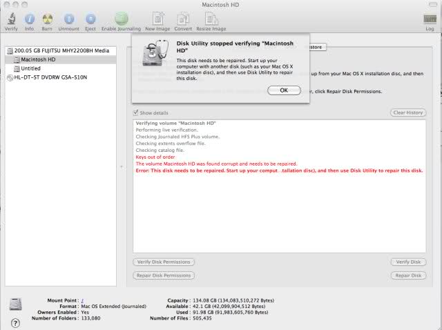

I ran Disk Utility, repaired permissions, now I can at least get on the internet (posting this from Chrome), but Safari still refuses to open.
Looks like the HD might be corrupt; here's the error I get when I try to repair the disk:
recap
So...I booted from my SL disc, tried to do a disk repair via disk utility, failed. The drive is indeed corrupted.
I was able to fix it, but I had to use Diskwarrior to do it. One tool that no Mac user should be without, imho.
