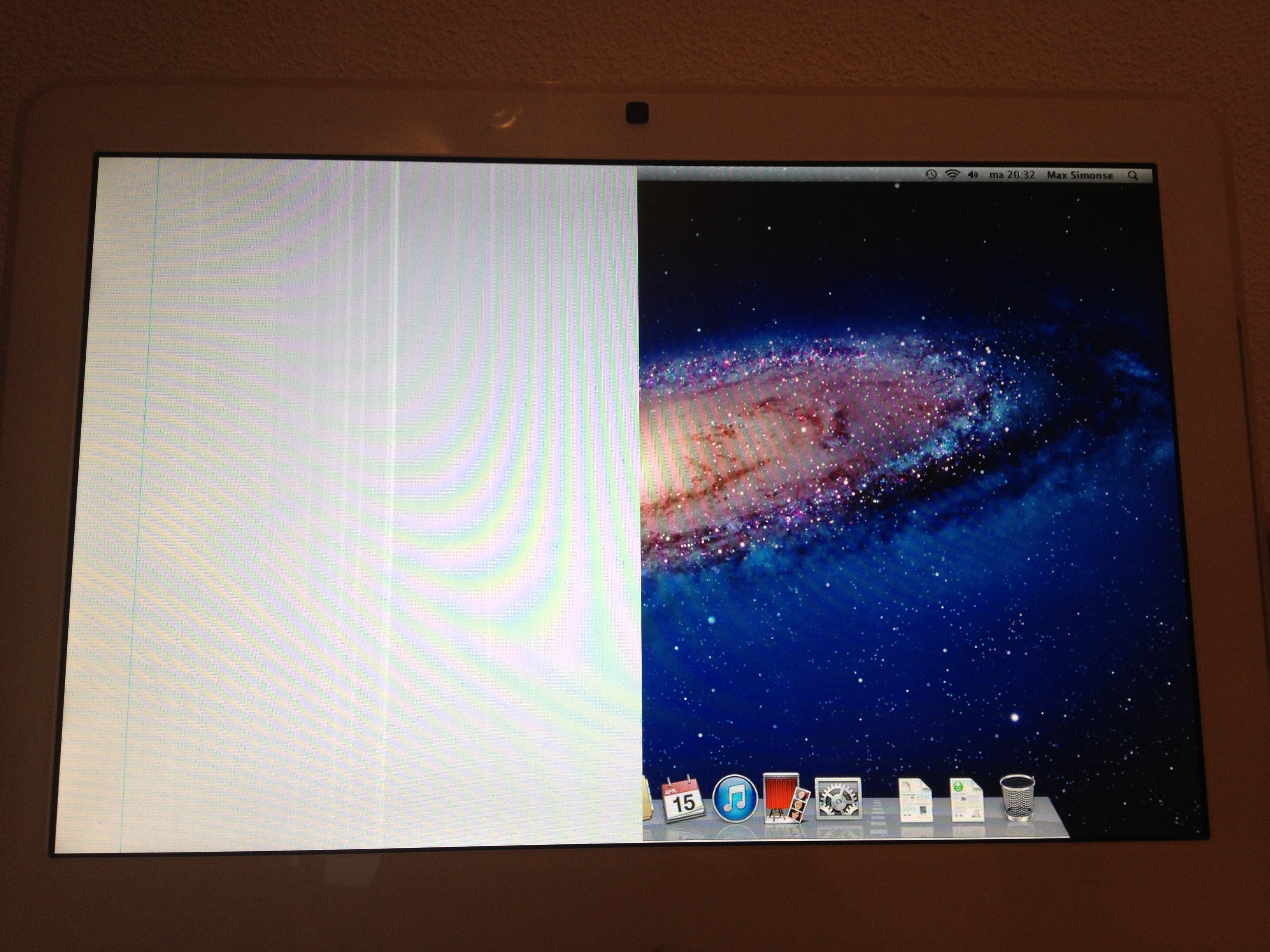

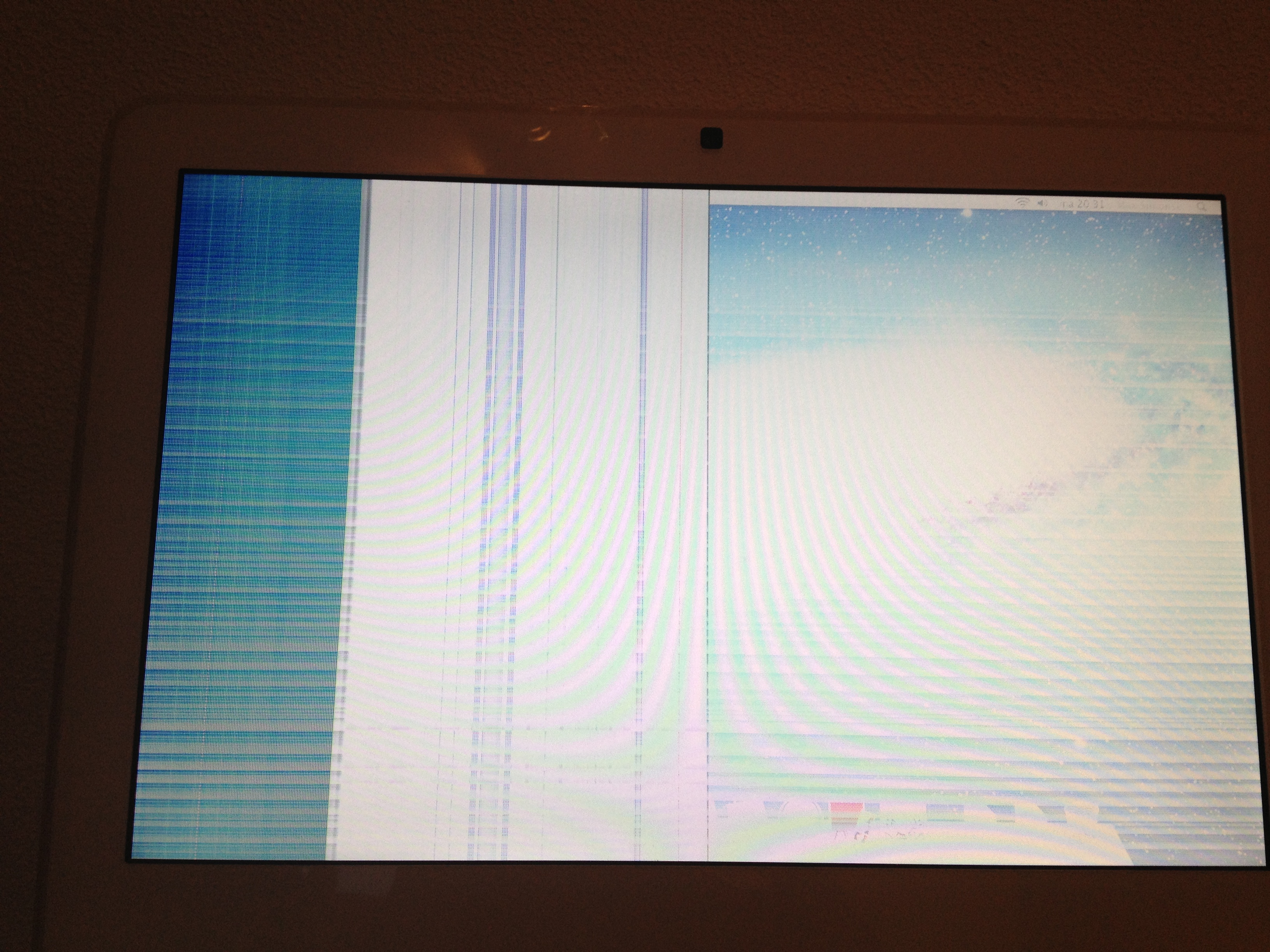

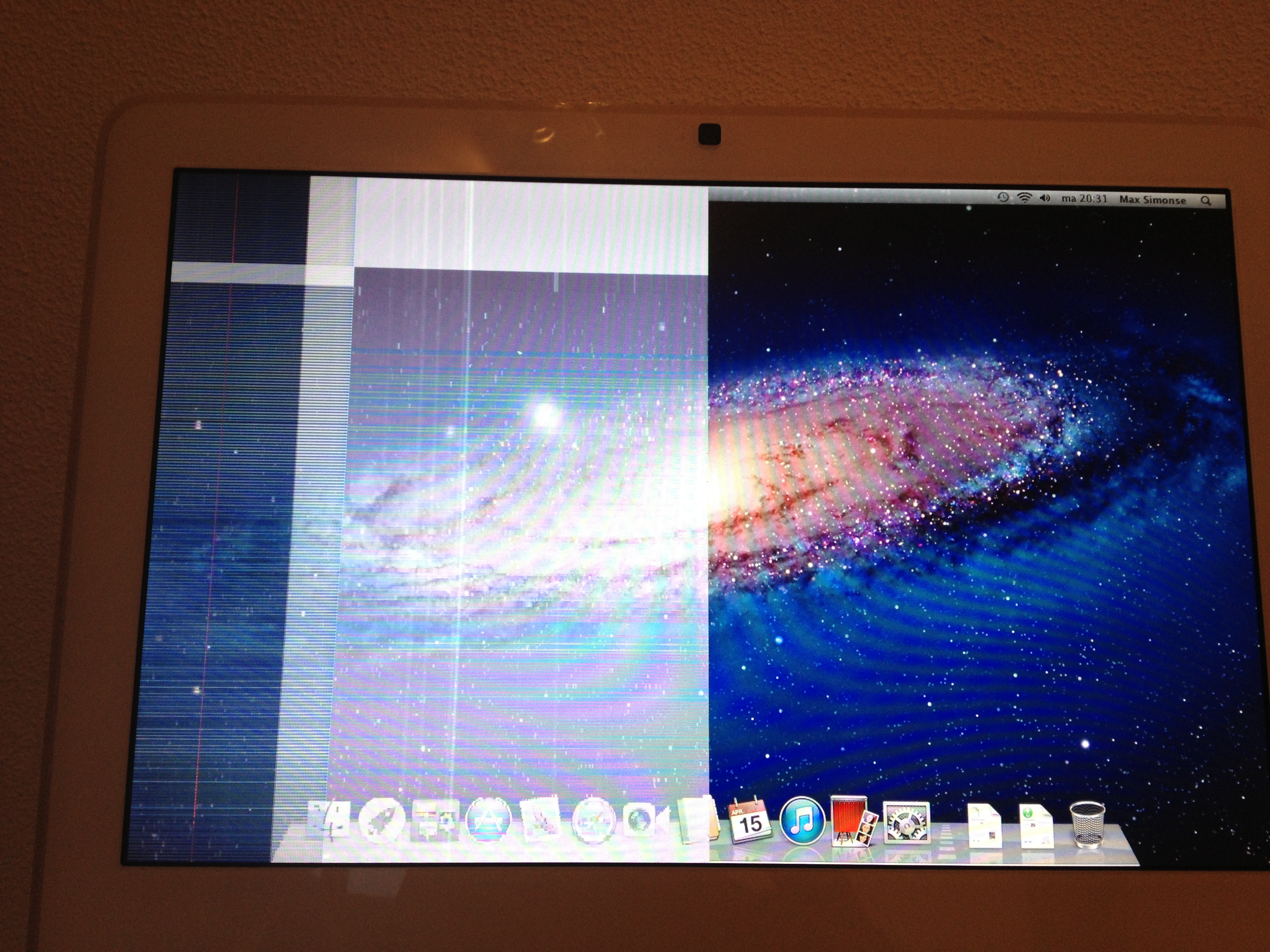

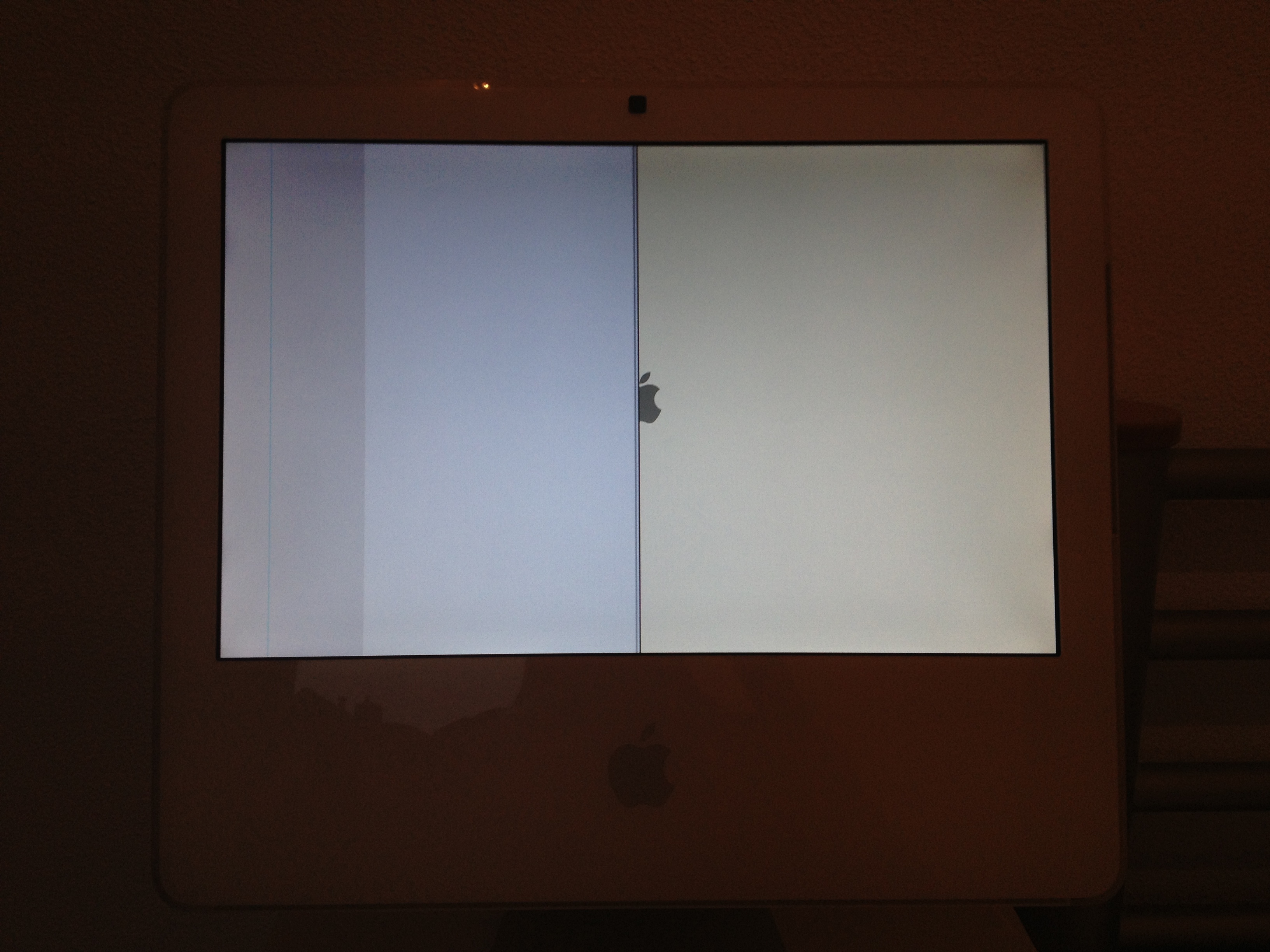

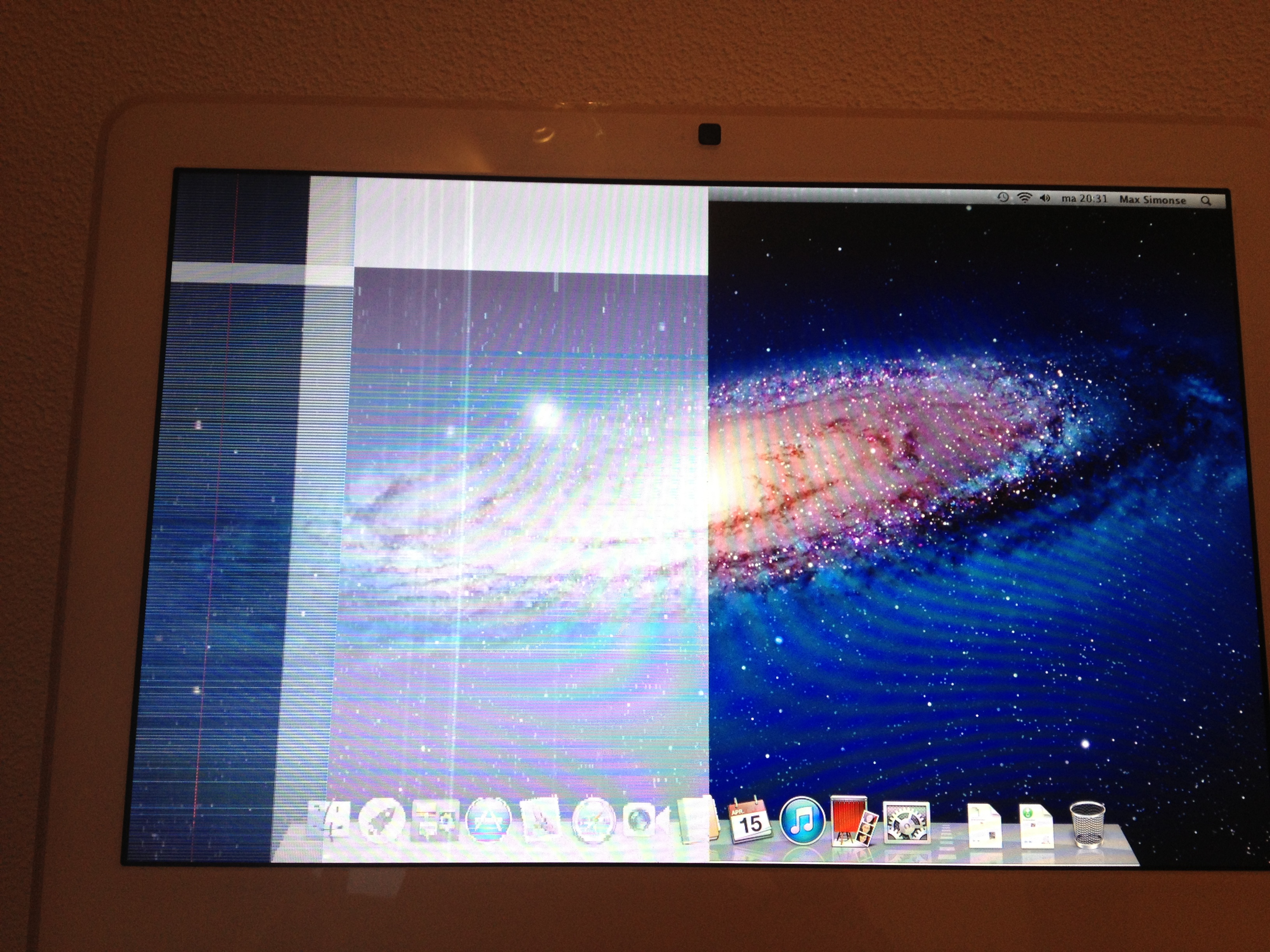

I'm new to these forums and I'd like to start off directly with a problem I have with my iMac Intel Core 2 Duo 1.83 Ghz from Late 2006.
There are actually two problems:
1. Only the right part of my screen is working correctly.
2. My iSight-camera isn't recognized/working anymore.

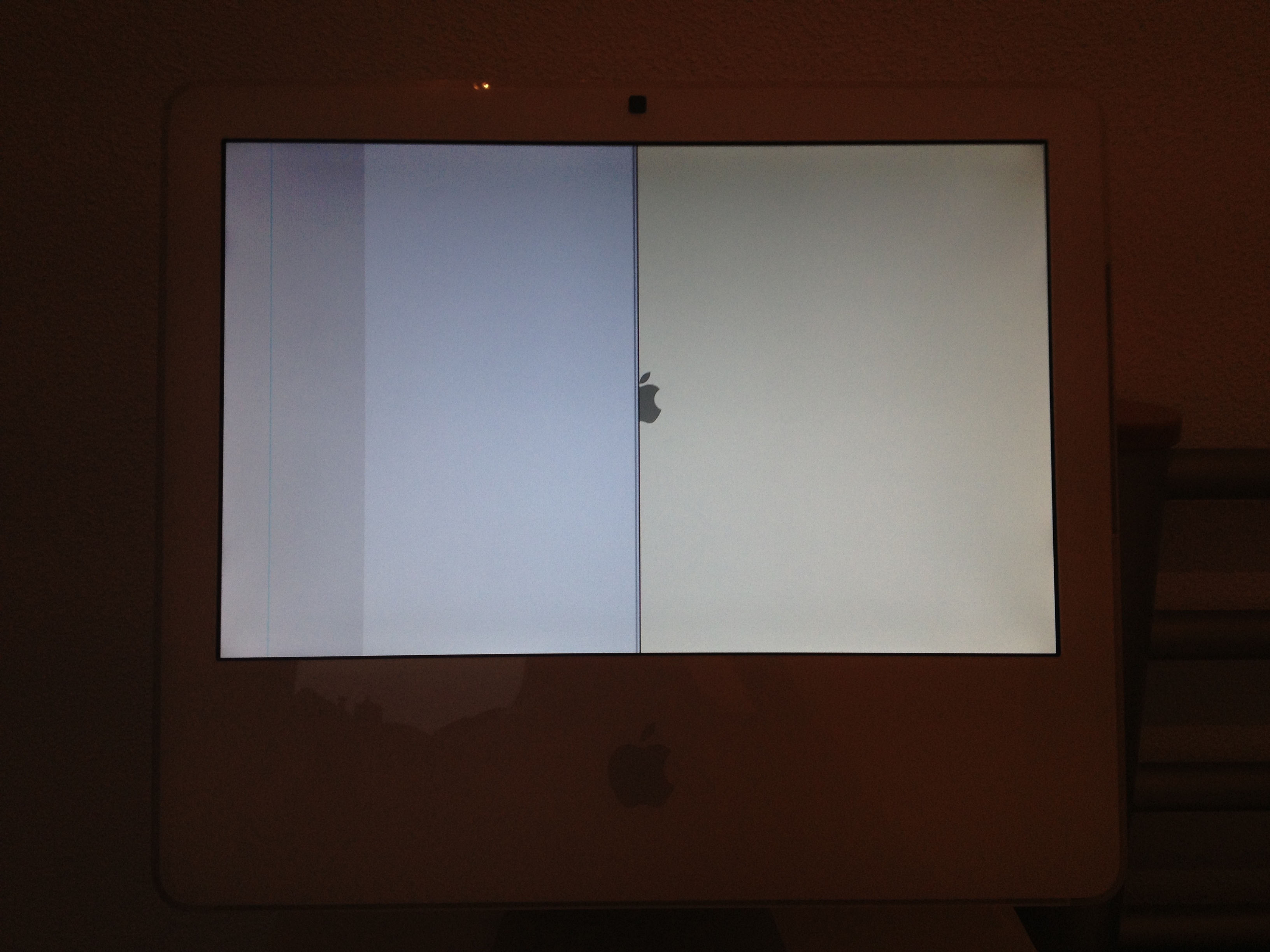

When I start up my Mac, the screen starts flashing and flickering on the left side. For half a second the screen is fine and then display disappears, separated from the right half of the display with a black line in the middle of the screen. When the iMac comes out of sleep mode, the same thing happens. I connected the iMac to an external monitor which worked out fine. I also did an Apple Hardware Test and it didn't find any problems. So, the logic board seems to be ok. AHT didn't warn me about any problems with the LCD too. I'm now thinking of a loose connection anywhere in the computer, but I have no idea what to try.
My iSight-camera isn't working too. But everything looks well connected. The camera is not recognized by the iMac in the way that it's not detected in the System Profiler.
Any ideas on how I might fix these problems?
Your help will be much appreciated!! 🙂
(Update: Photo's of the problem are now added!)

If it was a problem with the connection for the screen I don't think the screen would work at all. I think this is a problem with the LCD itself.
As for the iSight. Not really sure. This could just be kaput. Does the system not see it at all?
Thanks for your quick reply! No, there is no sign of the iSight-camera at all. The iMac says there is no camera connected when I start up a program like Photo Booth, and it's not recognized in the System Profiler too.
iMacs with serial numbers starting with W86 and (at least) W87 have screen that often go bad. Google "imac 17 screen lines" and you'll see how common this is. From what I've read, the way to test that it is a bad screen is to take a screen snap. If the picture shows your desktop as normal, you've got a bad LCD.
Solution- new screen. Apple has replaced peoples screen in the past. Maybe if you are a big enough pest, they will help you out.
