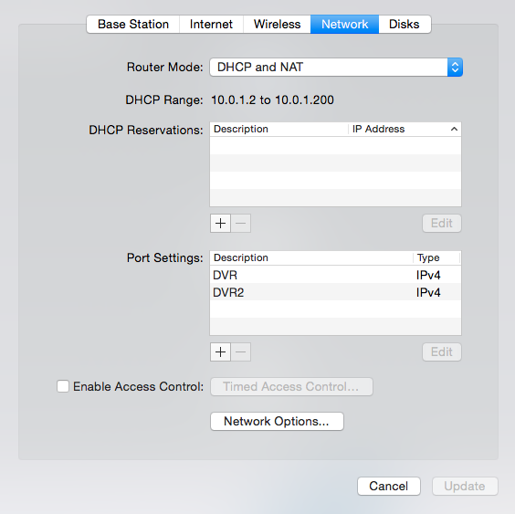

Report back whether it is in bridge mode or not. Usually when they start to act up they are on their way out but we can check a few things...
Here you go.
Thank you Altemose. I had 7.6.3 and then upgraded to 7.6.7 with the same results. I'm thinking its toast. If I can find 7.6.1. I will try it and then update you.
I am not going to lie to you and say that it is not the case, but I have found that doing the downgrade will give you reliable use out of it. You should be able to option click the version number in AirPort Utility to downgrade to that firmware. I had an Extreme do exactly what you have happening, with random Wi-Fi drop outs but remaining a solid green status light. By downgrading to 7.6.1, it miraculously ran fine! I have no idea why, but I believe it was attributed to load. It would work fine when a few users were online, but if it was slammed it would fail.
