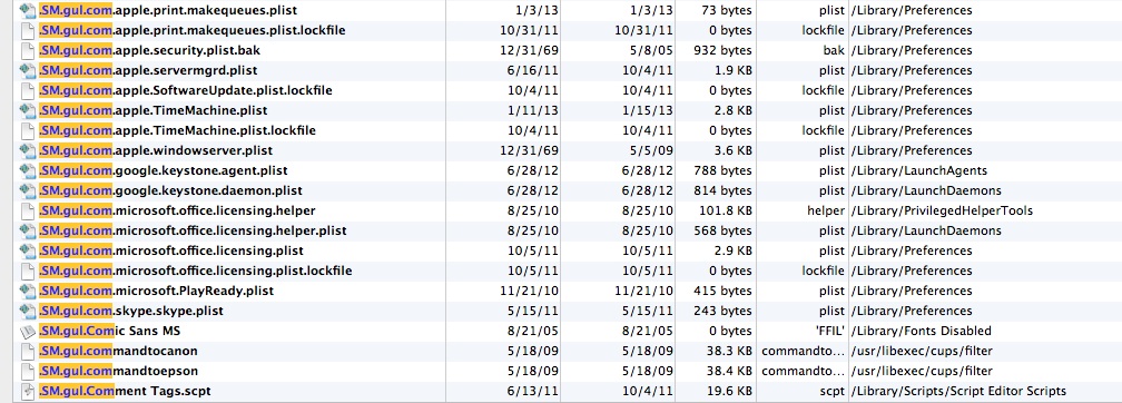

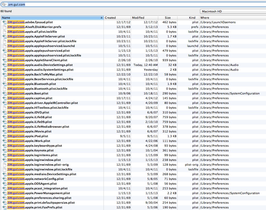

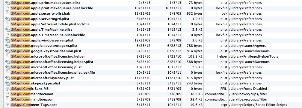

the devon technologies apps look great; am trying to use the Easyfind App, searching for SM.gui.com; it's finding MANY files (attached screen-shots). Are you sure it's ok to delete all these?
If you give the go-ahead I will give it one last try ... getting to feel like wiping the hard drive and installing a 10.6 OS is the only reasonable choice here.
cheers! 😎

Yes, they are all OK to delete.
Didn't you get more results, are you sure you searched with invisible files on and inside App bundles?
I had many more.
This won't likely solve the problems, these are leftovers from Migration Assistant.

well, I've painstakingly located all the .SM.GUL* files, even the hidden ones and trashed them all. Re-started the computer, and Adobe Application Mgr still crashes (even tried re-installing it). reset the SMC, still no change.
