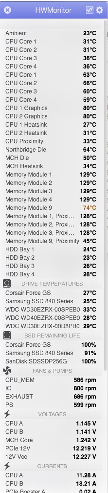

observation: on a hunch, I just downloaded a temperature sensor app, and the modules on the DIMMs are running at 129 degrees C. That seems really hot to me. I know that this type of RAM is supposed to run hot (the reason they all have heatsinks attached), but this hot? Interestingly, if I manually ramp up all the fans to max speed, DIMM temperature doesn’t change. I've attached a screenshot of the temperature monitor program.​

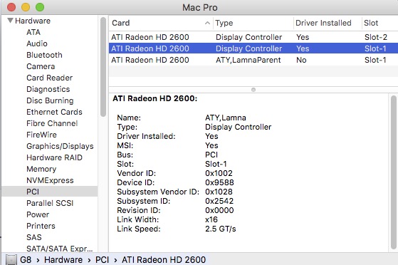

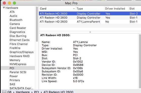

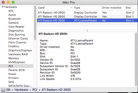

Well @Macschrauber, I have received my replacement ebay-purchased ATI Radeon HD 2600 but...I foolishly didn't make sure that I ordered a used Mac version, rather I accidentally bought a PC version, or so I believe, as it is shaped differently (longer, and has a third port outside, which is round). Booting (with successful chime) with my monitor plugged into the new card shows no signal being set to the monitor, arrgh! I guess that OSX doesn't have drivers for it, or, alternatively, it's missing Mac specific firmware (an issue that I vaguely remember from long ago, when Mac users were searching for cheaper PC versions of their video cards).
Interestingly, System Information says the following (note: my old 2600 is plugged into slot 2, the new one is plugged into slot 1):
Note how it says that a driver is installed:
but also note that it says a driver is not installed:
Not sure if any of this might be useful to me (I realise now that I haven't tried my monitor in the other DVI port on the new card).

In some combinations the efi of the mac Gpu drives the PC gpu. had such a 2600 combination running back in the days.
if you pull the mac 2600 the pc 2600 may dont work anymore.

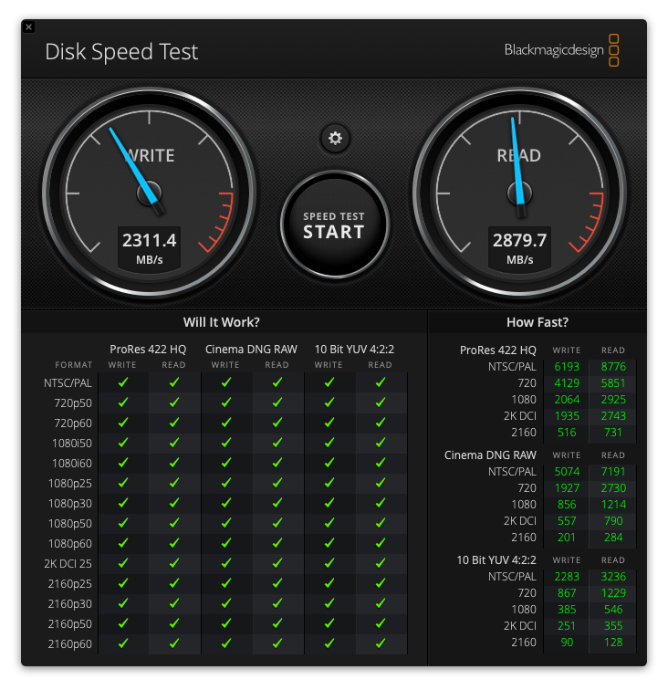

And, for completeness' sake, here the speediest on the internal SSD (256GB on this M1 Mac Mini). Phew!
