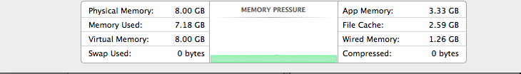

This last MBP I bought was a lemon - since 2011 I've had the display, RAM, HDD, logic board, battery, etc. replaced (none due to damage).
Recently there was intermittent freezing/wouldn't start up - the genius bar couldn't find anything wrong or re-create the issue, but of course it immediately happened as soon as I returned home from 3+ days of testing. Ultimately they suggested it may be a corrupt version of OS Mavericks, so I just reinstalled it and crossing my fingers, it seems to be working again.
However, processes seem to be slower than they should. I'm pleased that fans aren't running nearly as much with Mavericks, but am wondering what the bottle neck is.
The typical tasks I find delays on is photo editing/data uploading/10-20 browser windows open running work - lags in switching photos/editing/expose.
When I check activity monitor - it says there is no swap going on (and also 0 (0) swaps in/out when checked through the top utility in terminal). However, I'm consistently running 6.5+/8 GB - a typical activity monitor is attached (shows low pressure, but still high usage with little activity).
Should I be concerned about this and would upgrading to 16 GB help with any of the lagging/delays? Or am I missing the issue completely?
Thank you for any help and excuse the naivety.

Looks like you have a slow HDD. I suggest you go buy an SSD and watch your Mac boot up within 12 seconds.
Go ahead and do the memory upgrade. I installed Mavericks with only 4 GB of RAM and just went up to 8 GB and I have noticed a difference in speed. Less beach balls.

Not sure if I wasn't clear, but again:
I have an SSD and 8GB RAM. I've done a clean install and things are operating fine (with some minor lagging).
The issue is the activity monitor reports that I'm maxing out the RAM, but the "memory pressure" remains low. (Picture is attached to first post)
My question is if I'm misunderstanding how Mavericks is using the RAM and if I will see significant benefits from upgrading to 16GB. I've read that since there aren't swap outs/page outs that the system is actually operating fine (that the memory pressure graph is more indicative of actual performance) and upgrades would be marginal improvements.
But I'm having trouble understanding and wondering if I'm missing the issue completely.

the green bar in your picture indicates your RAM is being managed just fine and no need for any RAM upgrades
this might help
http://support.apple.com/kb/HT5890

Doesn't seem to be a RAM issue, at least in terms of RAM size. It can be a defective module, though. Running Apple diagnostics tools with Command+R after turning on can help finding something wrong...

Thank you for the help - I still don't understand how a high percentage of RAM is being used constantly while the pressure remains low, but I guess it's better for it to operate functionally than for me to understand it.
its confusing to read but "memory used" also includes inactive memory which is the same as free memory
also with OSX ive noticed even if you have 16GB of RAM simple tasks will use more RAM than usual just because there is more to use
