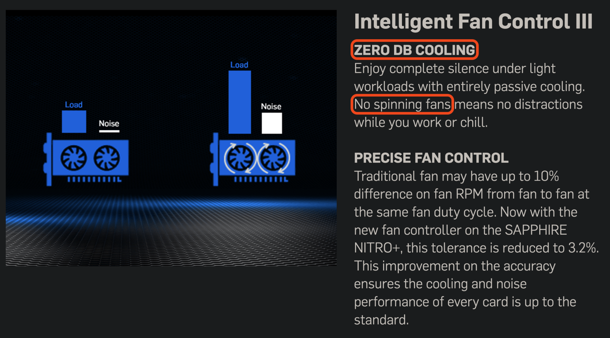

Most likely your RX580 and RX560 are working properly. This is from the Sapphire webpage
Anyway, how you connect the monitor? Any adaptor in between? A direct DP or HDMI connection should be very reliable.

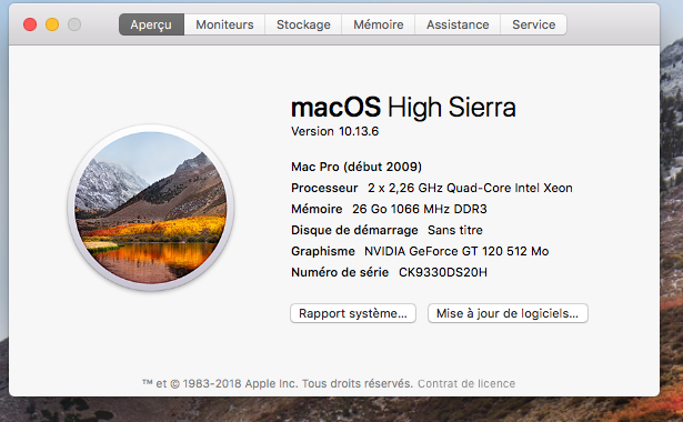

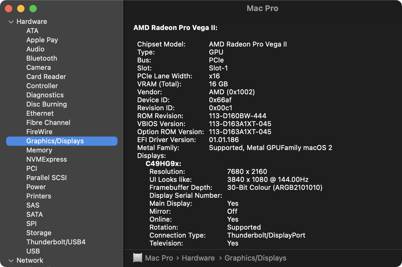

When you install the RX580 with the GT120, did you check the system info page? If possible, please make screen captures like this. So that we can have better understanding of what's happening.

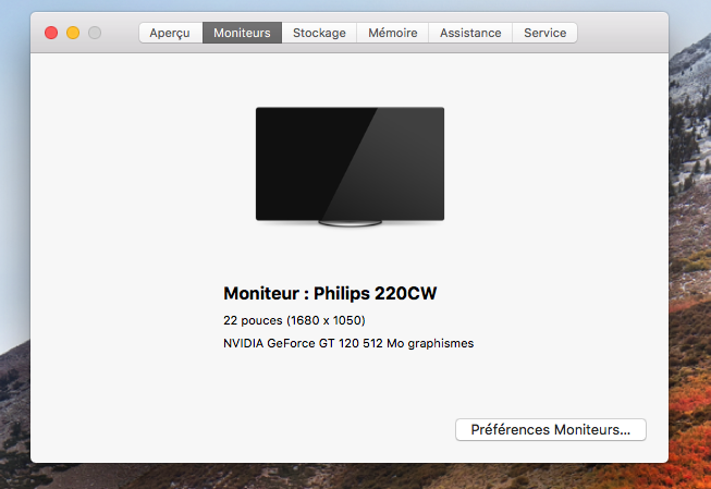

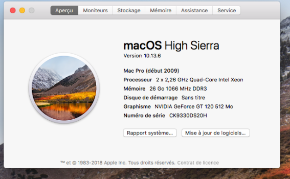

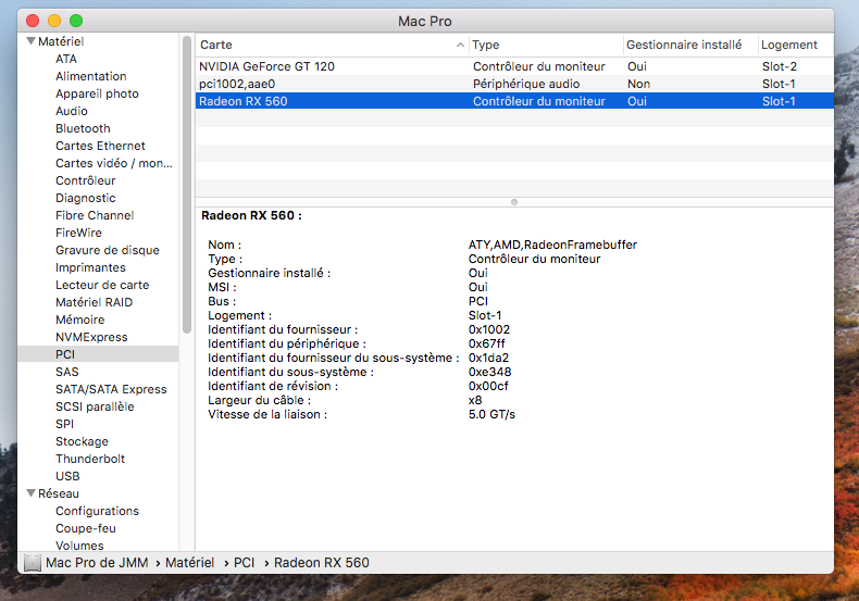

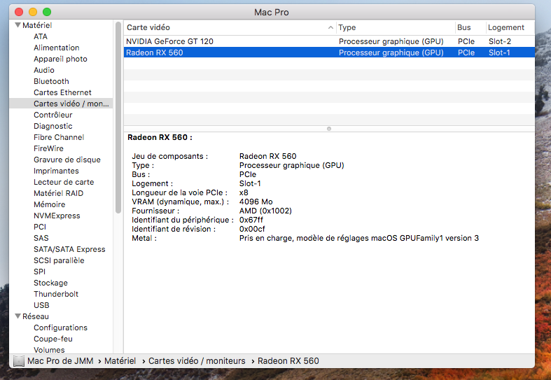

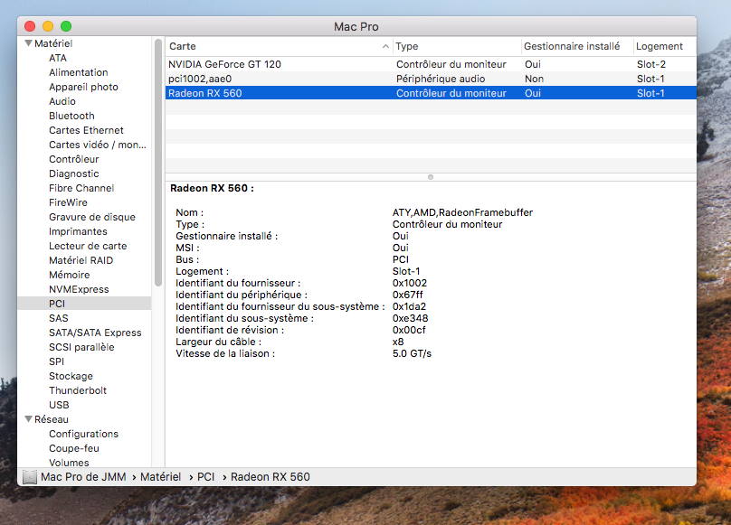

Hello and thank you all for the quick replies. Yes I formatted the SSD in APFS and installed High Sierra and Mojave from a USB key.
Here are the screenshots under High Sierra with the RX 560 in 16x slot n°1 and the GT 120 in 16x slot n°2. No video output on the RX 560. Which is incomprehensible as it seems to be well supported.

I seem to recall something waaaaaaay back, which suggested you couldn't run Mojave with AMD and Nvidia cards together....🤔. Try removing the GT120.
OOOuuups forget to post this
Try with just the RX 560.
Since it's a cross-flashed early-2009 you could have a faulty BootROM, is very common issue with Mac Pros that had a NVIDIA Titan installed in the past.
Hello and thank you very much, I know that, I installed Mojave from another Mac, but even after a clean install, the listed GPU cards installed alone do not show anything. But Mojave still shows up with the GT 120 alone...
I have already tried with the RX 560 alone, it does not display anything even after waiting for a very long time.
The BootRom was updated two days ago at the time of the clean install of High Sierra

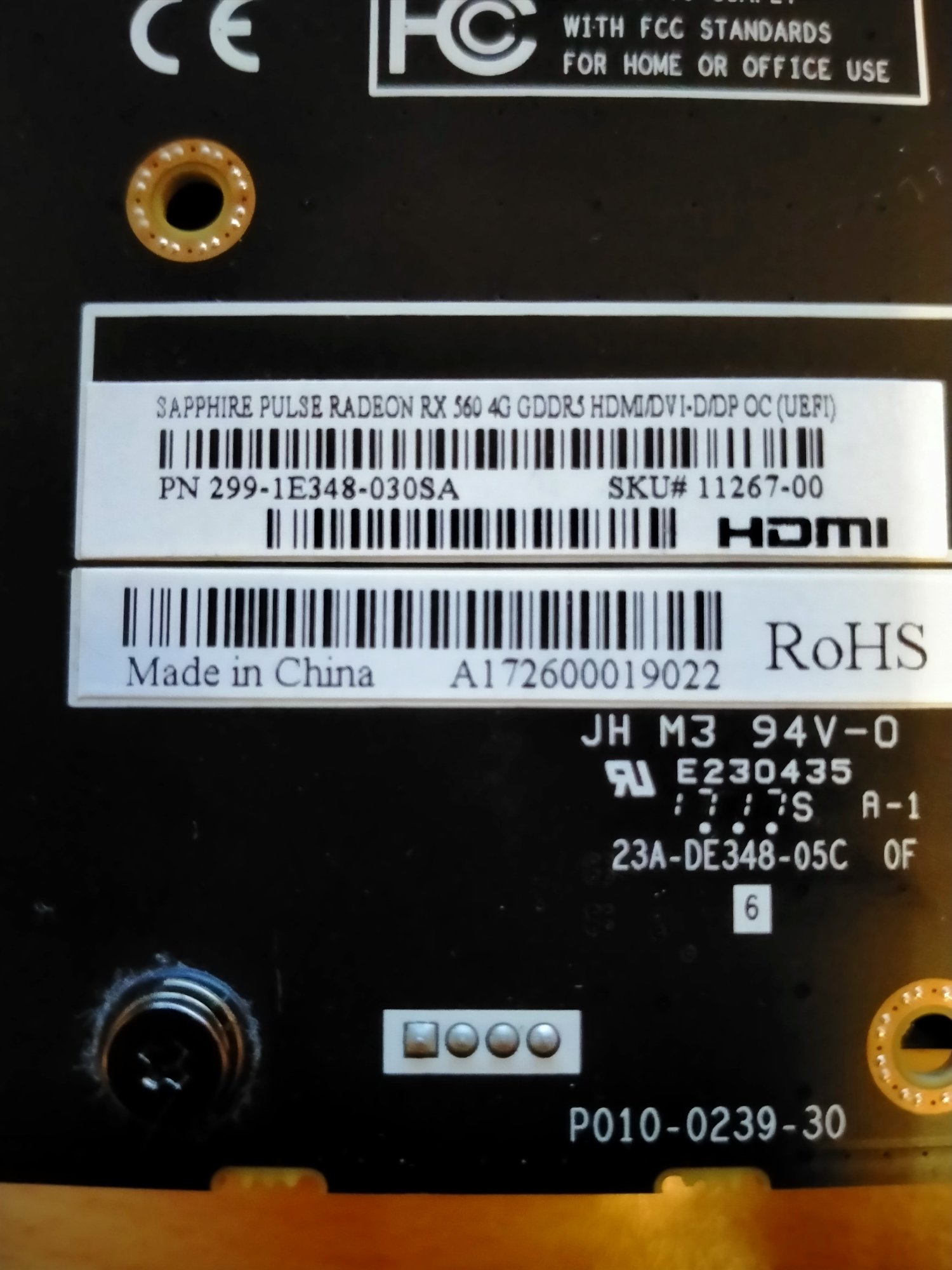

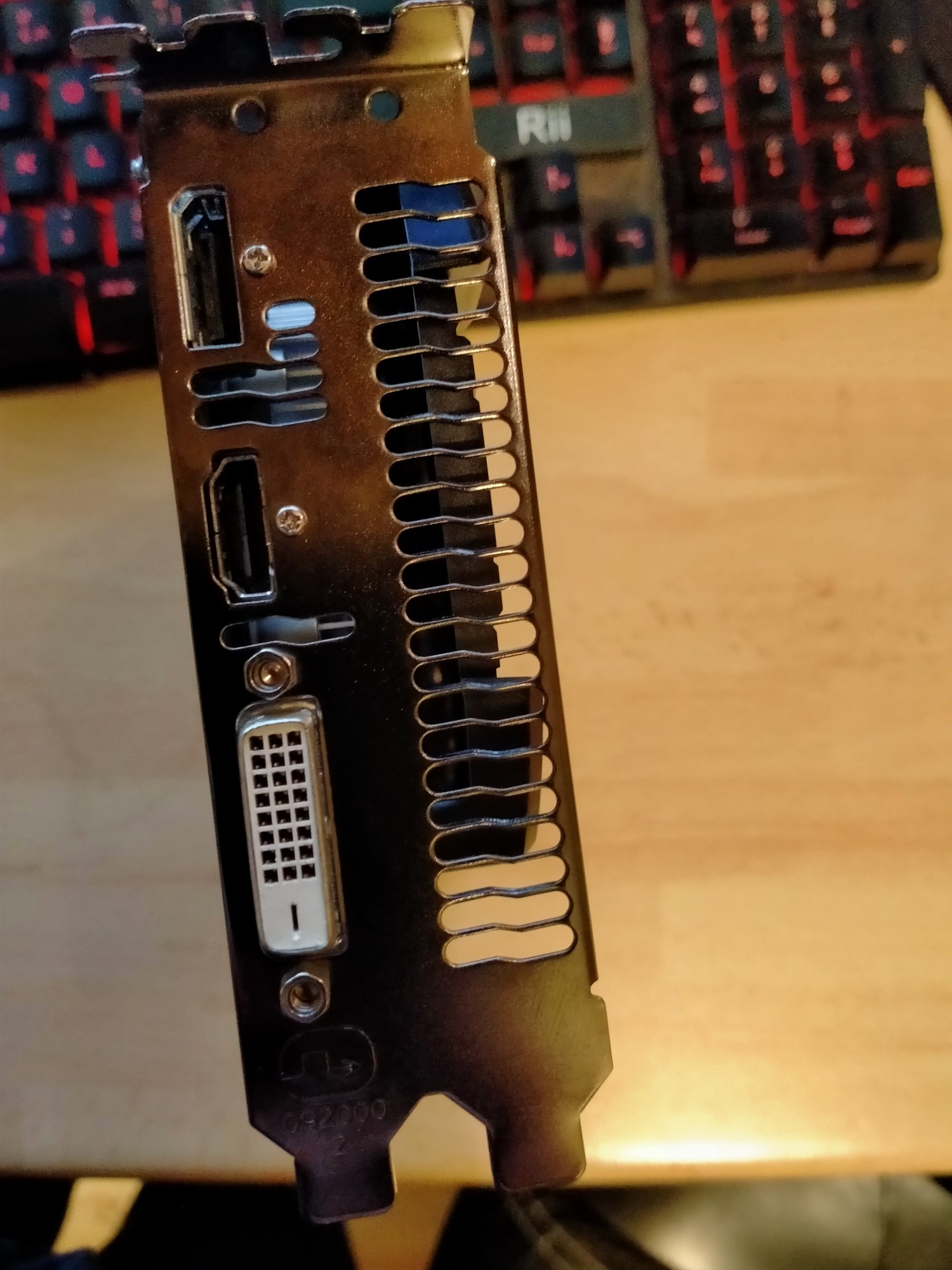

How your display is connected? Resolution? Model of the display? Exact model of the GPU (is one of the cost reduced Sapphire models)?

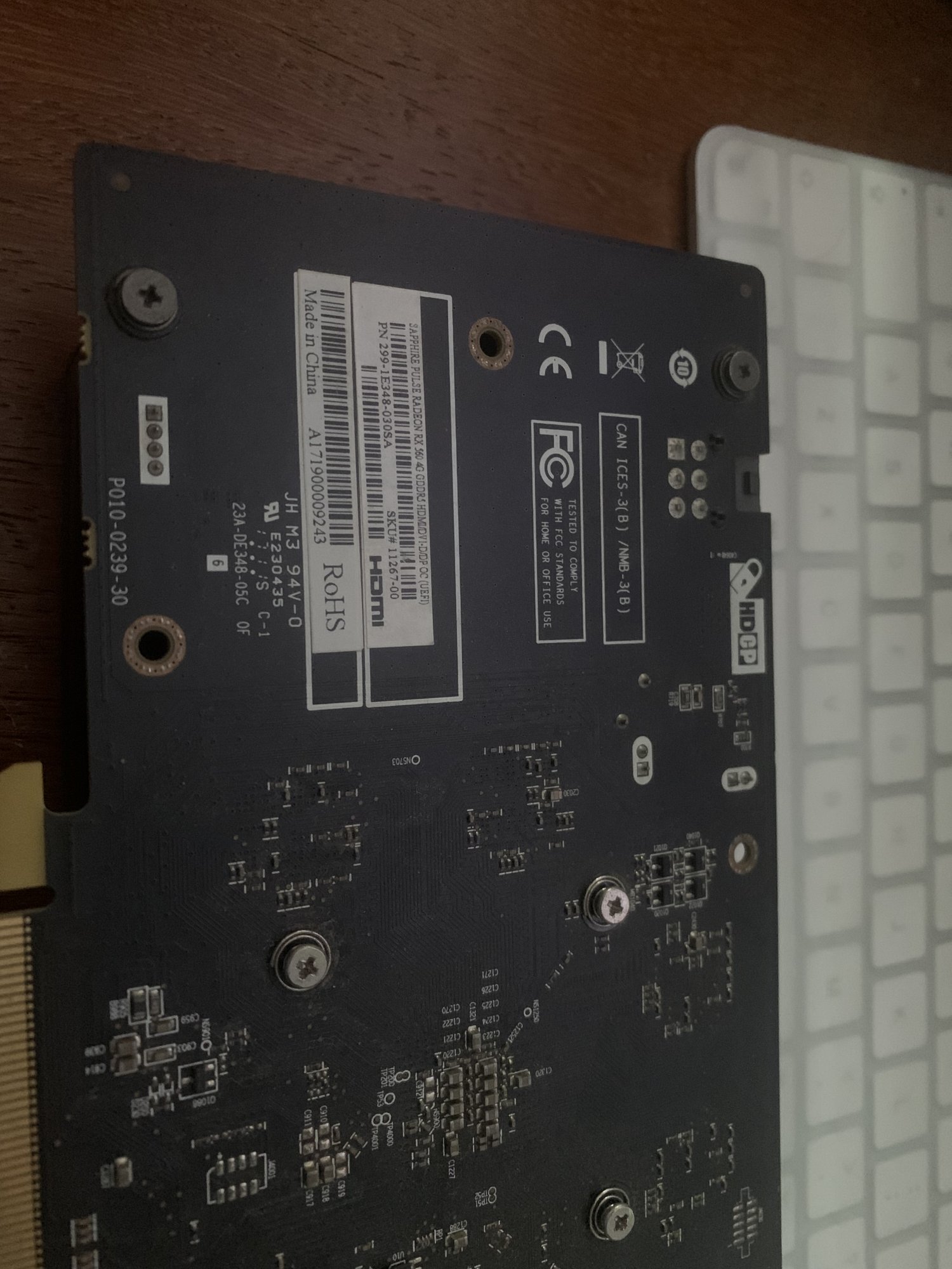

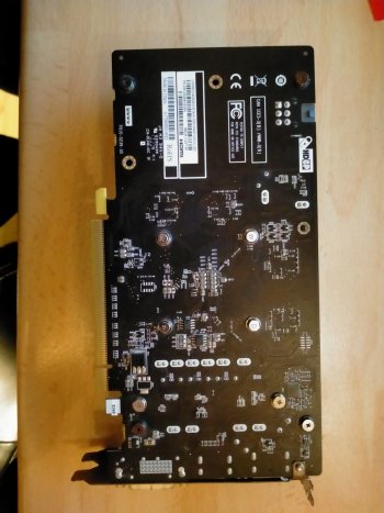

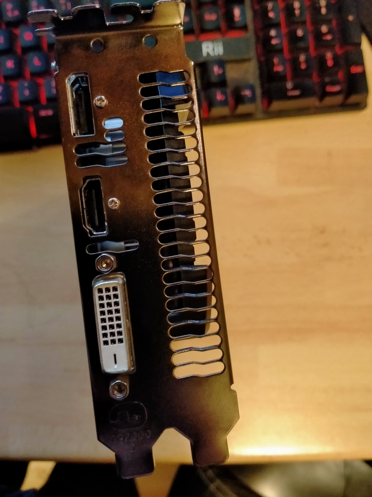

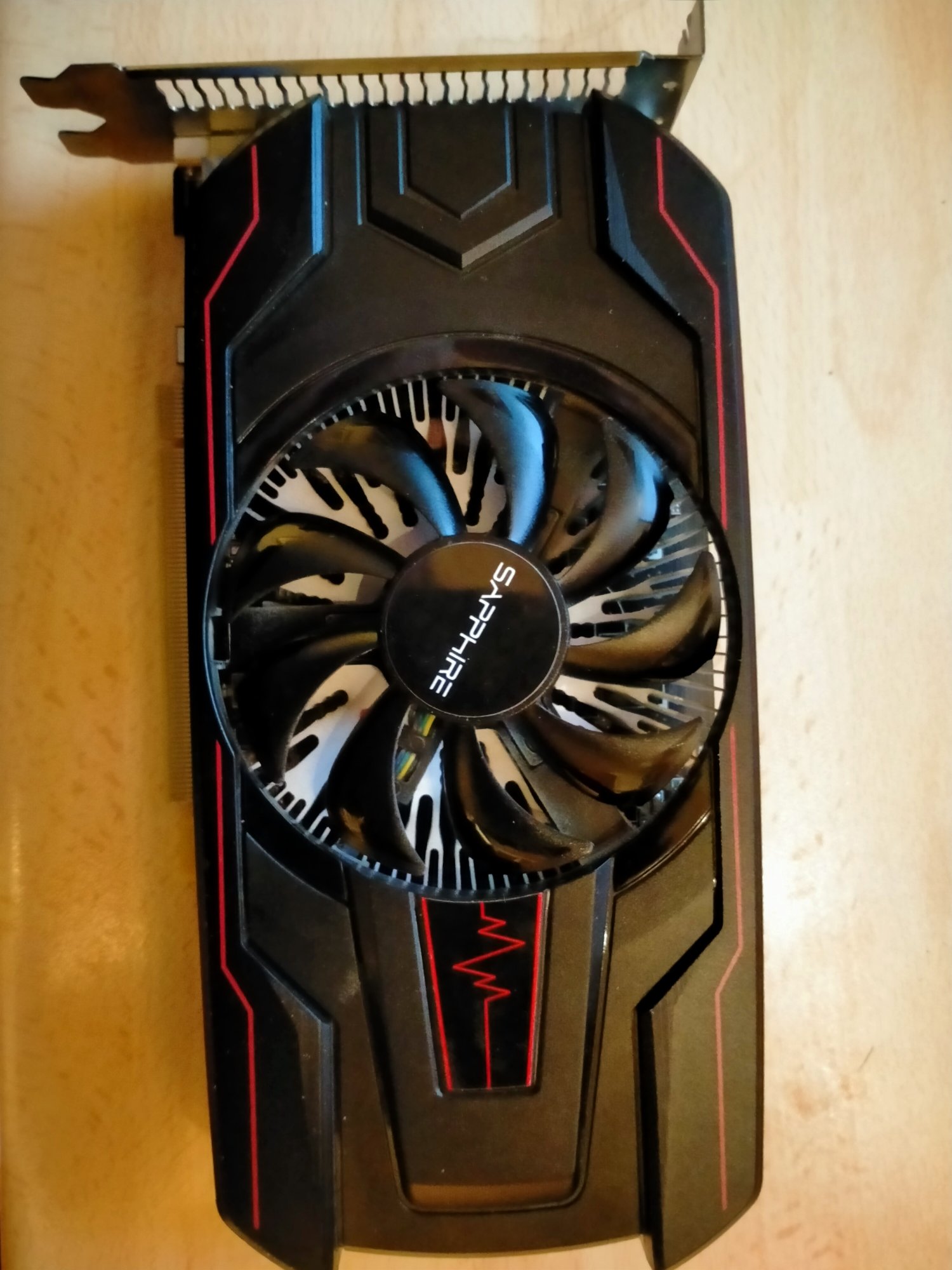

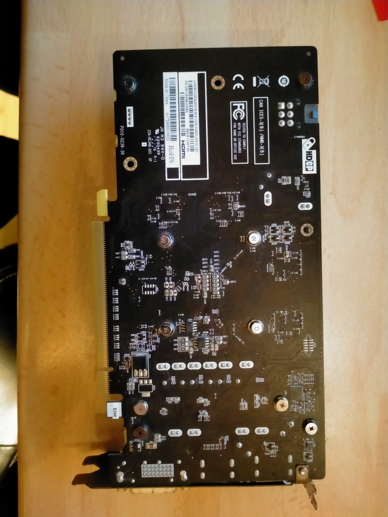

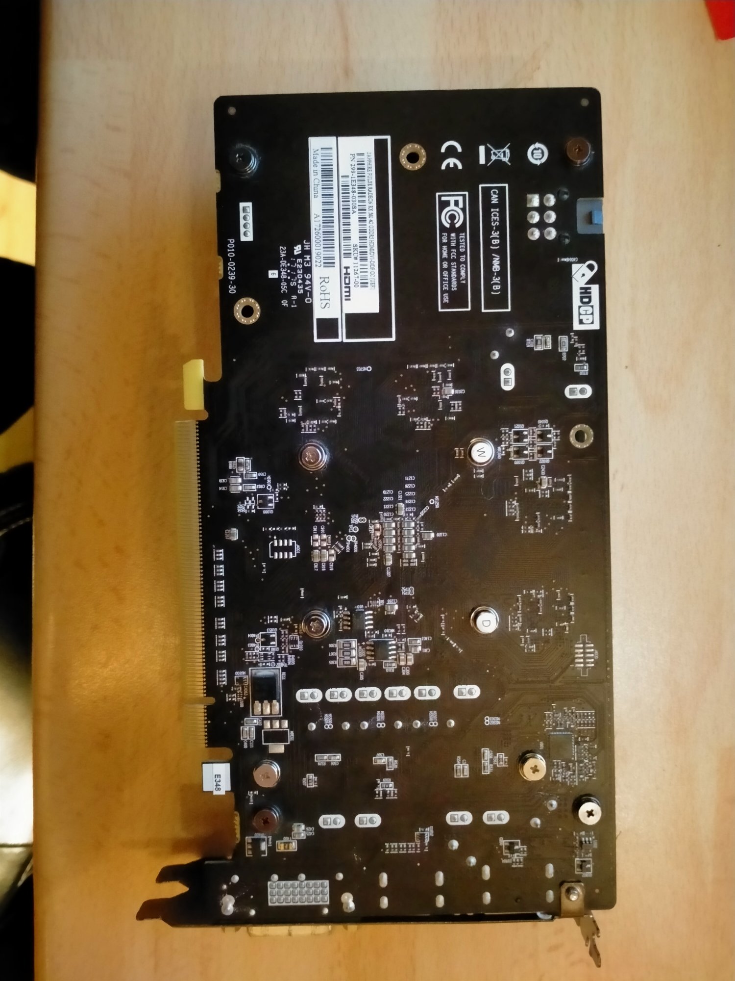

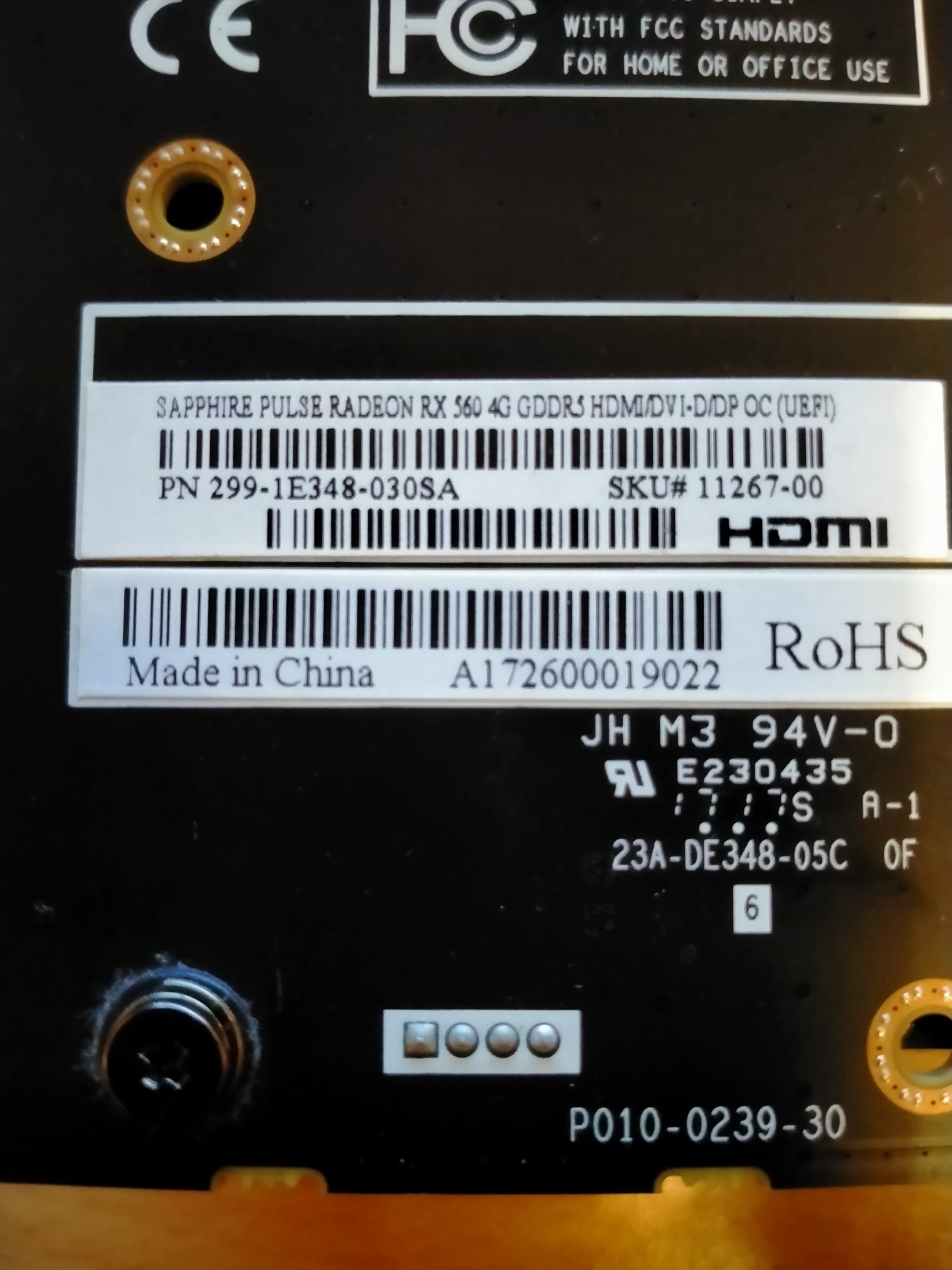

OK, I admit that I don't know anything about Bootrom. It is a Saphirre RX 560 Pulse with 4 GB, here are the pictures
I am using the DVI port
The card has been tested on PC and works perfectly, moreover it worked on a Hackintosh under Clover

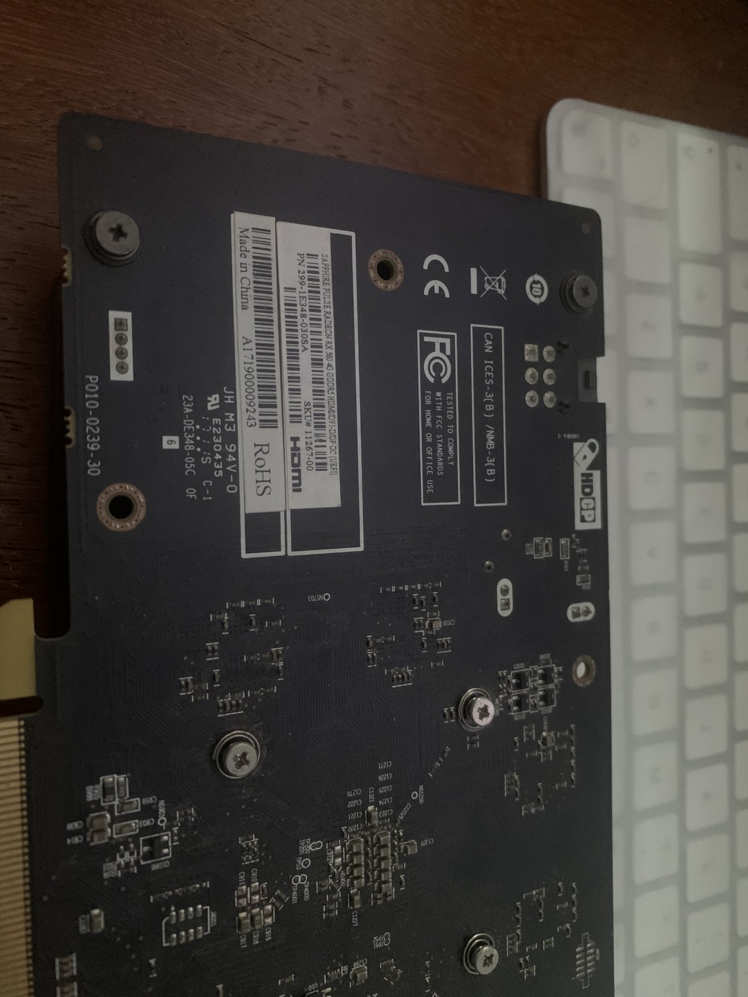

I have the same GPU, with the exact same part number, and works fine, so, from what you wrote the most probable issue is a corrupt BootROM.
I have the same GPU, with the exact same part number, and works fine, so, from what you wrote the most probable issue is a corrupt BootROM.View attachment 2124913
