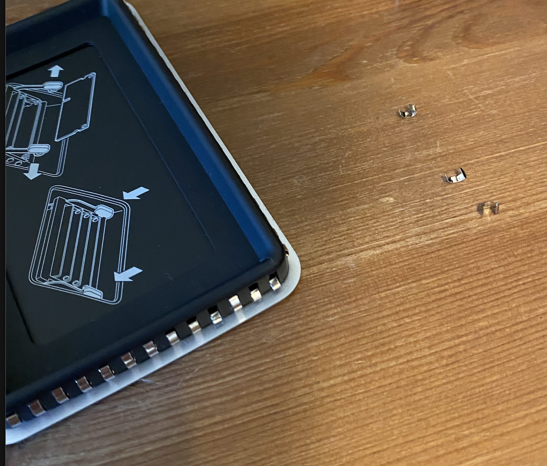

I had thesame problem with the RAM slot door. I thought the reason why my Mac doesn't turn on is because of that. One of the pin got knocked out. And it wont fit perfectly. It is slightly open.
I tried to add another OWC RAM 32gb 2666mhz mix with the original 2 4gb RAM. I did the pairing of slot but as soon as I have it done, my Mac wont no longer work. It doesnt turn on. Its been 3 days now.
