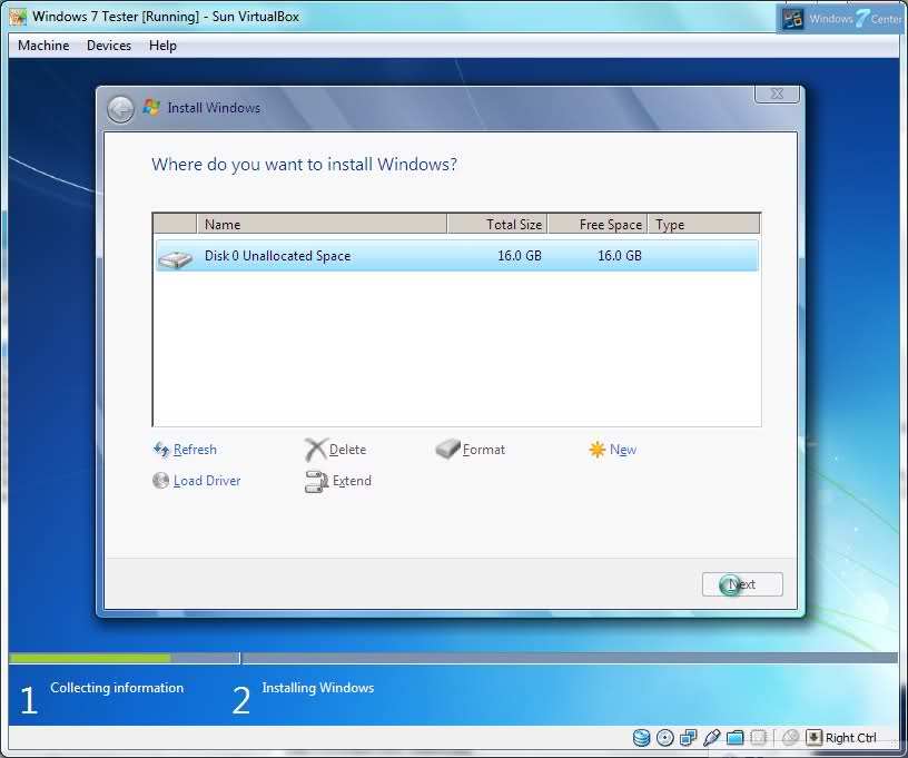

Let's see how we can remedy this for you. Are you saying that you're deleting the BOOTCAMP partition that OS X creates to prep the installation as soon as it reboots to start the actual Windows installation? You should NOT delete it, but instead FORMAT it as NTFS. Again, no re-formatting before you get to that point, i.e. you're out of the OS X environment and in the Windows installation. It's easy to find which partition you need to format, as the BootCamp assistant temporarily names it BOOTCAMP, which will go away after you format it (and hit Install).
