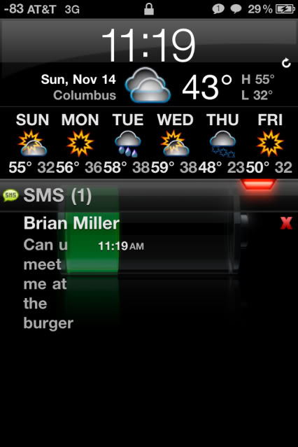

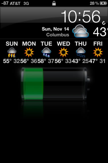

Hey guys, Ive been having a problem with lockinfo for a while now. Pretty regularly when ever I get a text message, the message will not be displayed properly on the screen unless I tap to open it. Another thing is that when I do respond, the clock usually goes off center and I am not able to unlock the phone. Once I put it to sleep and wake it up again, all is ok, but it's pretty annoying. I've contacted the developer to see if there was a fix, or an update comming out, but he doesn't seem to know what's causing it. Anything I should look for or try? I'm using high gloss theme (which worked fine before) and bitesms with lock info. Here's a pic of the off center clock.
Picture of texts.

OP, I've had this happen recently (sporadically) with my clock in LockInfo. It would happen when I would get a text (using BiteSMS) and turn the phone to landscape. After responding in the QR window, the text would disappear (like it should) but the clock would be pushed off the screen just like that.
The only fix I ever found was to hit the little refresh arrow up there to the right of the clock...and the clock would move right back into the correct position.
