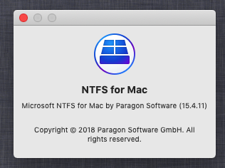

Thanks for the FYI! Trying to figure out if I can use disk utility to disable the extension at least temporarily. What version of the NTFS extension are you using? I have a fear I'm trying to use an older version of it that's not compatible with Mojave.
You may be right. Paragon does come out with updates on a fairly regular basis. I would imagine especially for the major release of Mojave.
Reactions: MiniMacDonald
thank you! I guess NTFS FOR MAC is NOT backward compatible, meaning that you can not use the current Mac OS with an older version of the extension. Obviously! Or else why even bother to come up with an update to the extension?
