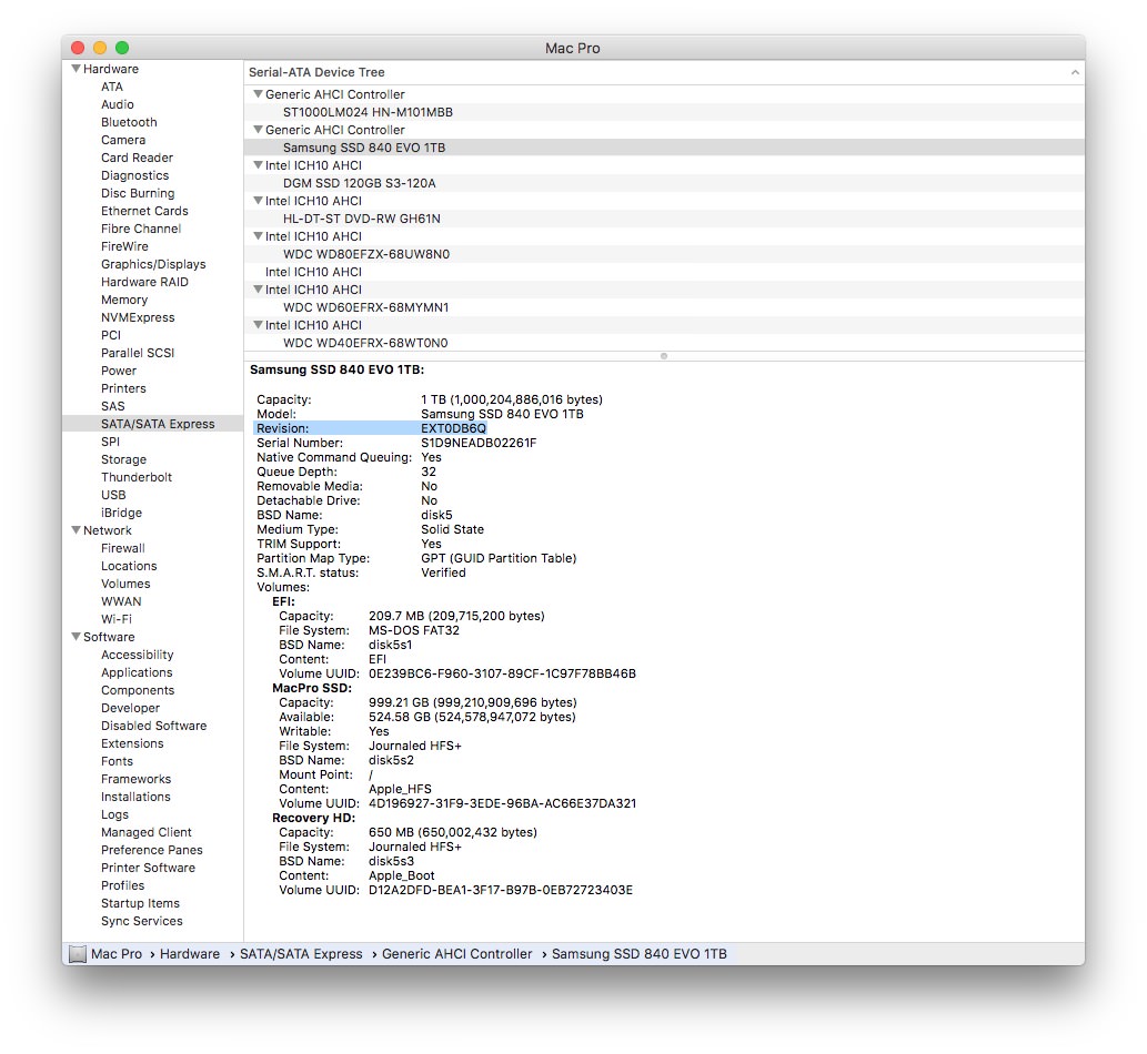

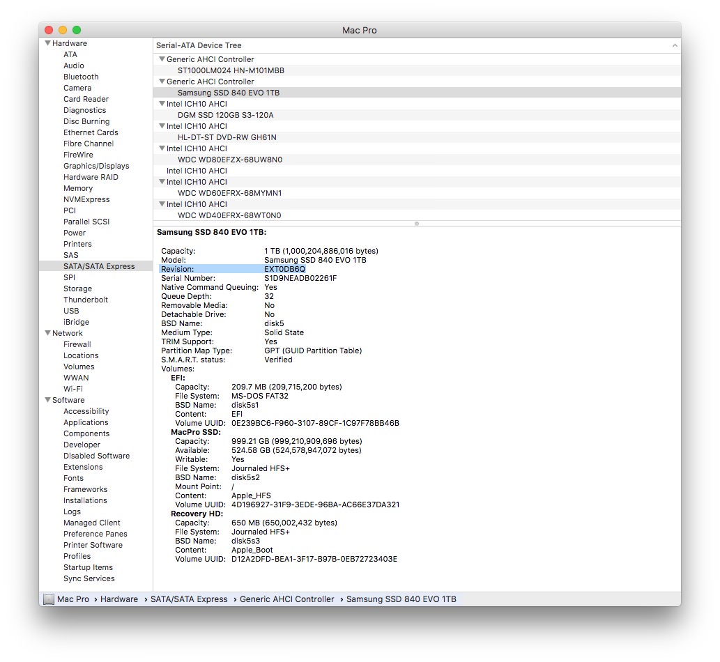

It's a SAMSUNG SSD 830 Pro. How do I check the firmware on mac? Got rid of bootcamp a while ago.
Firmware version is here.

And here's where you'd download an update.
http://www.samsung.com/semiconductor/minisite/ssd/download/tools.html
The latest version for the 830 is:
CXM03B1Q
If you have anything other than that exact firmware then I highly recommend that you update it.
