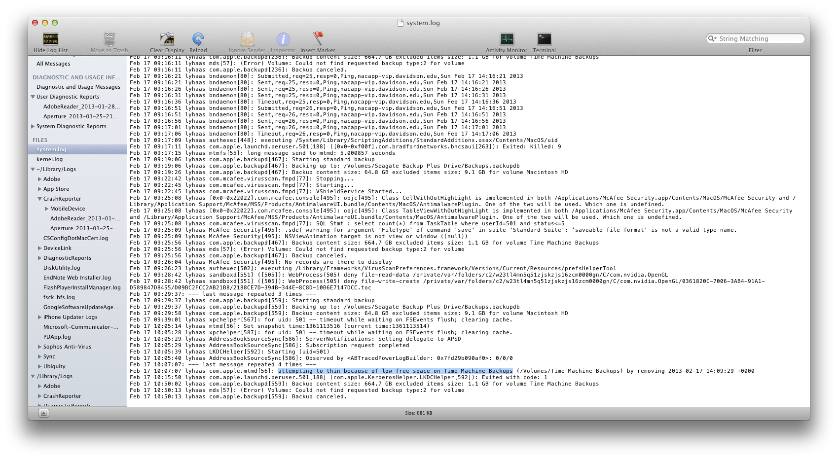

To get more information about what Time Machine is doing, you can run Console.app, select the log for "all messages" or "system" (I can't remember the exact wording, I'm not in front of a Mac), and then filter by "backupd" (without the quotes). This will show you all the Time Machine messages.
If you can find the point in the log when the issue occurred, you can click on one of the log lines to select it, then clear the "backupd" filter to reveal all messages again. Your point in time in the log will still be selected, so then you can take a look at the messages from other processes around the same time to see if anything seems "funny". Maybe USB errors or some sort of disk error.

Thank you very much for telling me about Console. I didn't think to go looking at the utilities that come with a Mac. I found a mixed bag of clues poring through the system log. Most interestingly, on some but not all occasions where backup failed, there was a series of four function calls on the drive object which each in turn timed out then the attempts stopped. It wasn't quite clear from the naming what the function call was attempting to do but I am guessing it involved waking the drive from sleep. Of course, with all power saving turned off the drive should not have been asleep to begin with and I was not attendant at the time so I can't know for sure if it was. Just the same, this appears to be what happened in some cases.
The fact that Time Machine melts down in this scenario, taking Finder with it is disconcerting and confusing. I would expect error handling for a case this common to be in place and to handle a failure to access the drive for any reason, be it power, disk failure, read or write failure, etc. I would also expect an error message to the user to indicate this failure, preferably including the nature of the problem encountered. But no!
At one point, the drive appeared to be asleep when Time Machine was not scheduled to run and I noticed this. The drive light went off so I assumed it was asleep. I ran Seagate's own simple diagnostic test on it at this point and it failed. I ran it again and it failed. In fact, the test never seemed to begin. Normally a progress bar appears and it takes maybe two minutes to run. So I ejected the disk with Finder which worked. Then I unplugged it, waited a moment and plugged it back in. It was recognized and mounted in short order and visible in Finder. I ran the Seagate diagnostic again and it ran fine and passed the test. From this I am somewhat inclined to think the drive itself is flaky and erratic perhaps about sleeping when it isn't supposed to and reluctant to wake up when asked to. That is just guessing though.
I ran that Seagate test again just now where I noticed the drive light was off. It ran just fine and passed. The light never flashed or came on. Perhaps the light does not indicate power status but just disk access. It doesn't flash at all, it just emits a steady glow, so who knows?
