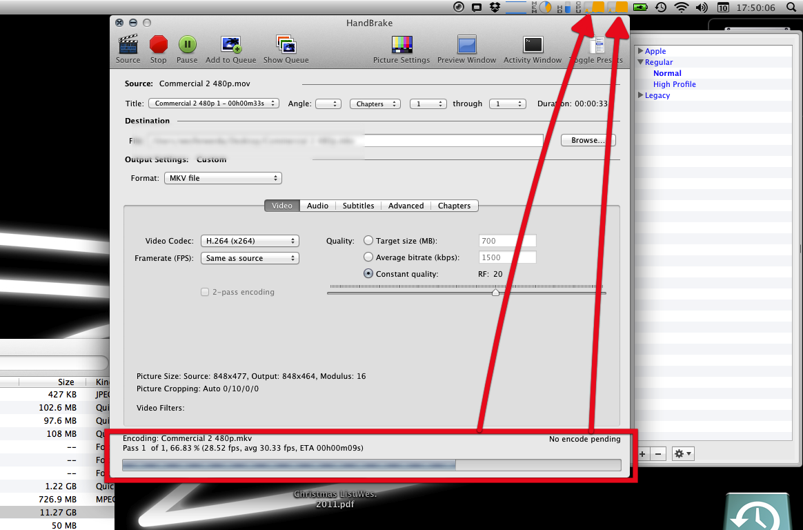

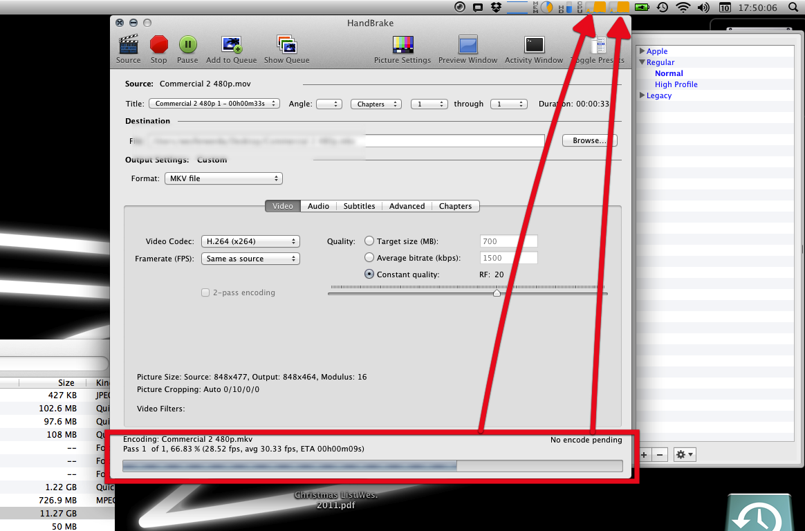

I've attached an image for proof. It's using 100% of both cores because the image is on my internal 7200 rpm HDD and not an optical drive.

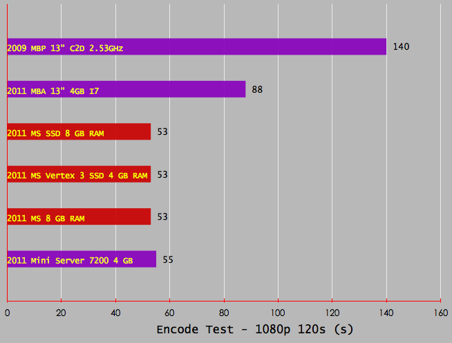

A faster hard drive or more RAM will not help your encode times. The two seconds difference between the 4 different quad core minis is basically inconsequential and can be discared.
