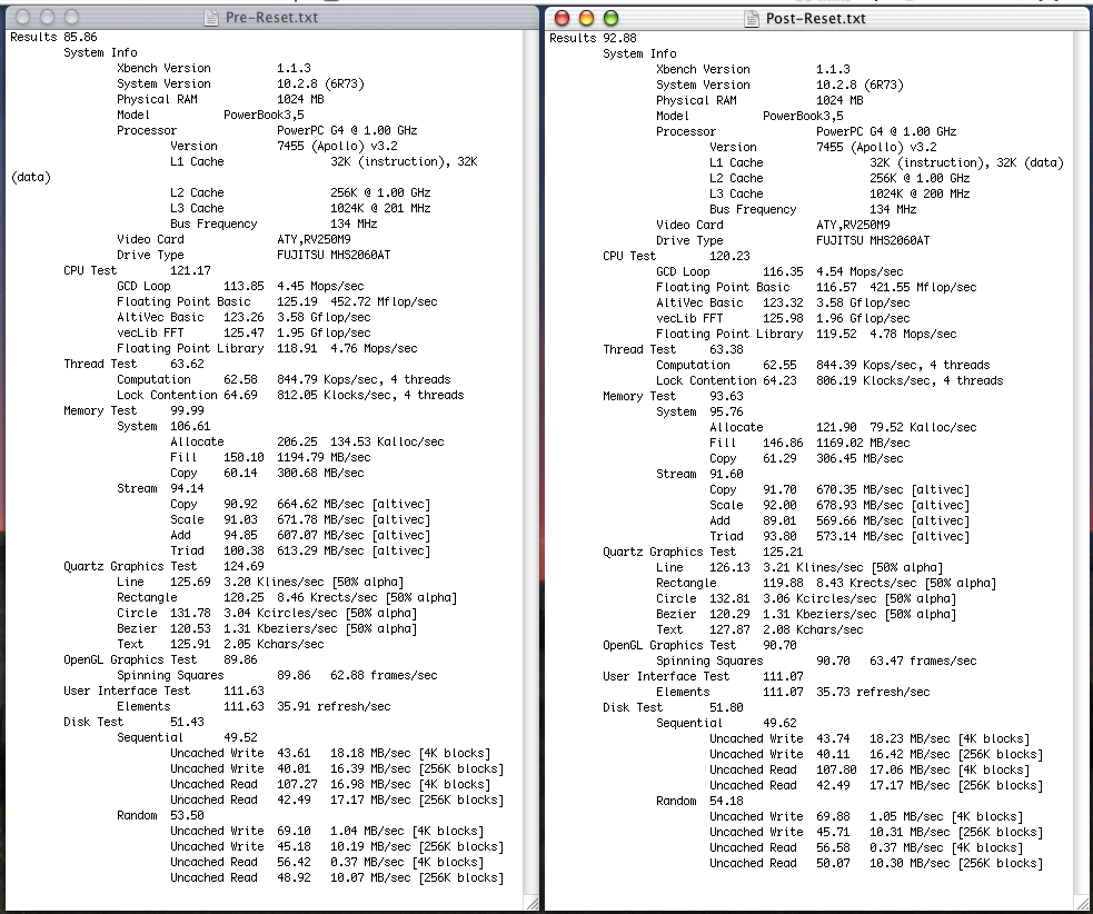

Xbench results from my TiBook, pre and post PMU reset
Ok, here goes. I'm not much of a techie, so I don't know what exactly this means but it looks like things got a little faster after the PMU reset according to xbench.
I closed all apps except finder and xbench and ran it, then reset the PMU, and checked the hw.cpufrequency. It now reports correctly, although my clock was not reset possibly due to the fact that I have it set to check the network server for the time which I assume it does when I log in. I then quit Terminal and ran xbench again. Here are the results.

Mactastic, the only problem with XBench is that single results aren't very useful. Only by repeatedly running the test can you arrive a a useful measure of performance.
Try running the XBench tests five to ten more times (without powering down, just run them consecutively).
You'll find that the results may vary quite a bit.

Ok. I'll give it a try. I don't really notice it as feeling any faster, but I am curious to know where the problem is coming from and whether it has any affect on the system.
hw.cpumonitor is still reporting correctly though, I guess I'll have to monitor it and see when or if it reverts to 667.
